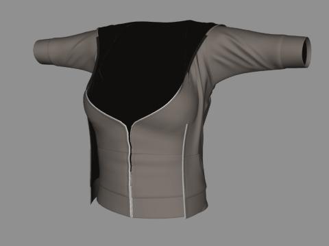

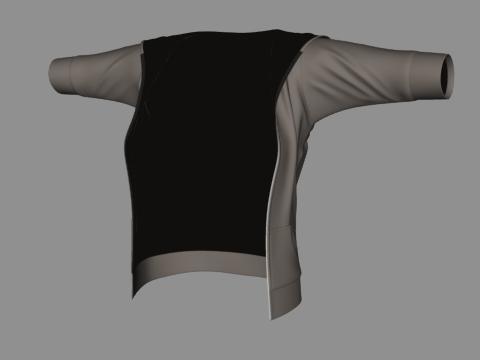

I load Hongyu's Sport Baby jacket and then I load the injection file which should have implement a zip-closed moprh but the original open-jacket geometry remains which results in a very weird look.
I have not used this figure since installing DS4.5. The DS3 handled these files properly.
Could somebody please explain to me what happens and what to do to make these files work properly.

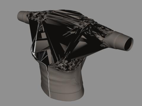

    I tried to load the separe geomety replacement files via morph loader. The abdomen region worked fine but the other three regions' geomety exploded...It is another mistey for me why does it happen. However if I were able to solve the problem with the morph loader I would be satisfied enough.

    The second: it ties to the solution I choosed. Using the morph loader pro (created a new scene and loaded the morph object files to a new figure) the morphs are created but the mesh explodes when I dial the morphs.

    I would like to describe once again what happens.
    1.) I load the jacket figure.
    2.) No slider appears in the parameters tab with which I could close the jacket, but the morph sliders which appear, such as wind, breasts etc. works fine.
    3.) I load the closed morph then the jacket zeroed and another mesh appears which shows the jacket closed. Neither of the morph sliders work anymore.
    What I suspect is that this behaviour has something to do with the additional geometry files (four by number). DS does not handle these special geometry properly. I suspect the pz2 file refers to these files when it wants to create a morph and not itself contains the deltas. But this is far over my knowledge.

    Hongyu used a very crude form of geometry switching with some of his early Gen4 stuff, and as Poser figures are nothing more than a collection of props held in a null, it makes changing the geometry call for a bone in a PZ2 easy enough to do without needing to properly code the geometry switching.
    DS1 - 3 were designed to work with Poser content, and as such they had no problems with this either, DS4 however was designed around the Tri-Ax system and Genesis, which means all figures need to be a single mesh with a "bolt on" skeleton rather than a collection of props. This means Poser content doesn't work the same in DS anymore, it has to be dragged kicking and screaming through our PZ3 importer, which converts it into a crude system similar to Genesis, all of which means this crude form of geometry switching doesn't work, as all you are doing is loading one mesh on top of another with it in DS4 rather than replacing them.
    You are basically left with three choices, 1) if it's a recent purchase see if you can get a refund, 2) use the geomtry switching OBJ to make them into proper morphs, or 3) learn how to properly code geometry switching.
