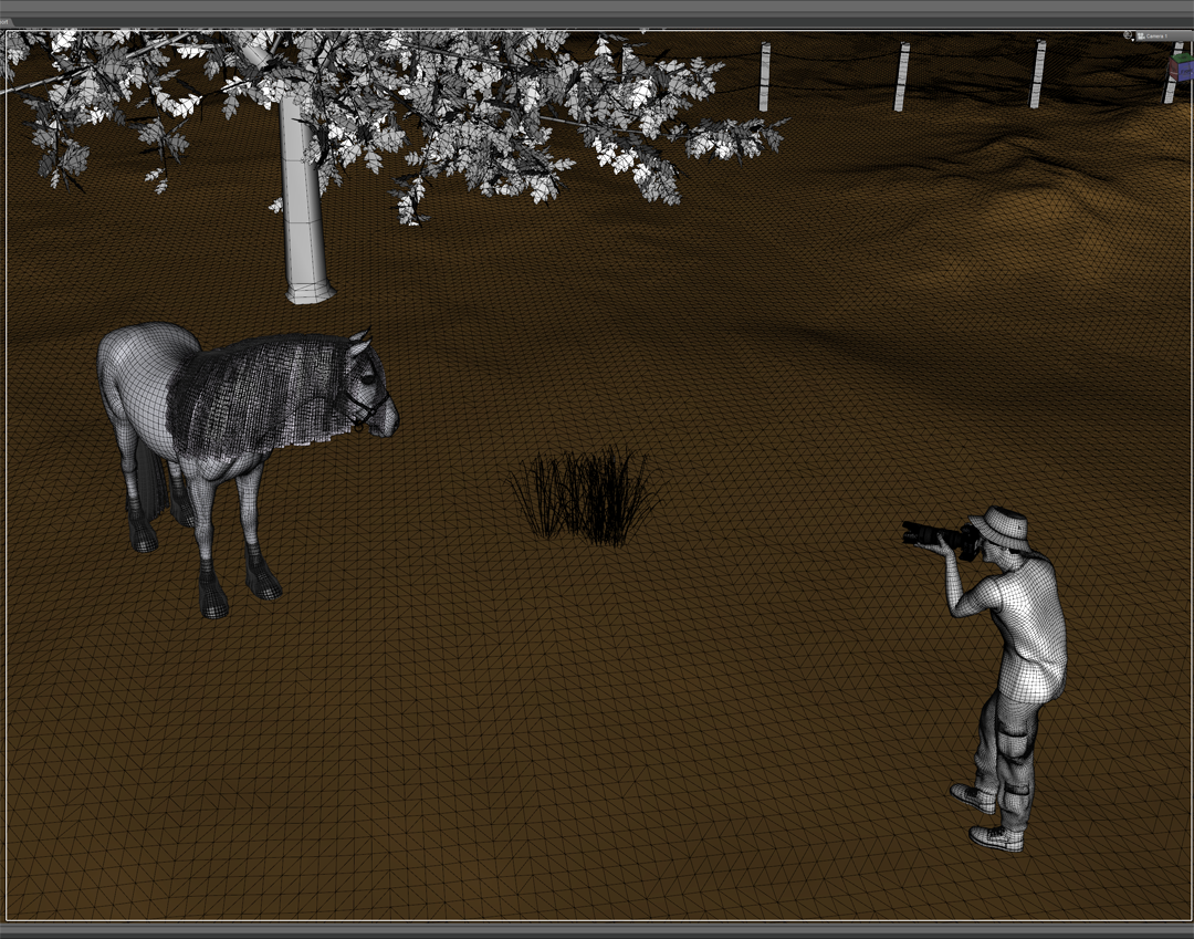

    Got it installed and seems to be just what I needed.  Thanks for replies.
