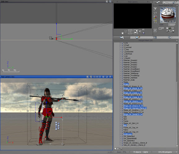

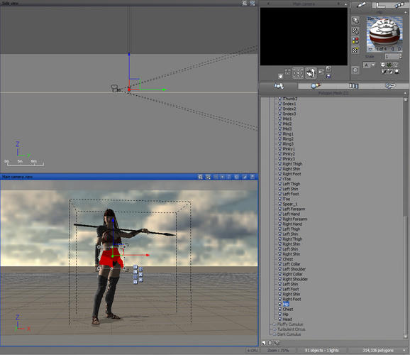

    Thanks for the images, I forgot that it might list the separate materials in there. However, I did quickly do a comparison and the .obj is so much easier to work with. The images below show the .obj and the .pz3 version of the same setup. In the .obj things are listed much better, meaning that I can select all of one particular thing -in this case, straps- and edit them all at the same time. The .pz3 has the skirt selected (Hip). In the material preview window it says there are 4 parts to the skirt, which is right. But each part would have to be edited separately as they're not using the same material. Whereas, in the .obj, the parts for the skirt are listed already, and as the belt part of the skirt and the underwear are both leather, I can change them at the same time as the straps, as there is only one diffuse texture map with this outfit.
    1147 x 992 - 270K
    1148 x 993 - 327K
  • glaseyeglaseye Posts: 1,312
    That's absolutely true..... much easier to edit multiple materials in one go.....:)
