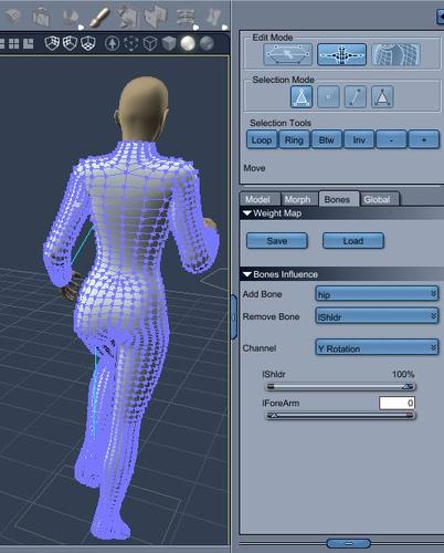

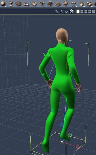

I'm trying to take the next step and create my own conforming clothes for use in Carrara. That is, not just attach a prop to the same skeleton in Carrara. In C8.5, I modeled a bodysuit for V4, then used Poser Pro's fitting room to rig and create a conforming figure and saved it to a runtime library. I then loaded the figure back to Carrara from the content tab. On the whole, decent results.
However, I'm getting spiking trails from the back of the shoulder/arms. I'm pretty sure this is from vertexes not being included with any bone (but not 100% sure), but is there any way to anticipate this and prevent it from happening?
392 x 632 - 40K

    here is something that explains why it happens in poser
    http://www.evilinnocence.com/xd-pose-fix-tutorial
    I usually hide the offending polys if I can't fix it ;)

    Thanks. I got one spike fixed by following those directions, so it is just a matter of diligence now. That was spot on, as usual. I will have to try a similar strategy in Daz Studio, and see if that is better. I was being lazy and wanted to let the fitting room do the grouping.

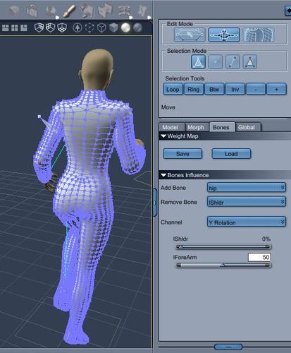

    I did figure out, however, that the spikeys can be fixed in Carrara by using the bone tab under the edit-animation menu. The vertexes are just assigned to the influence of the wrong bone. You can fix it pretty easily. In the attached pics, the spikey was when the influence was to the wrong bone in the y dimension. It went away when I set it to the correct bone.
    Didn't have to go back to Poser and adjust the joint zones.
    I did note that the edit-animation tab was not letting me create a new morph target even though I made sure to create a morph zone for the whole mesh before saving and exporting the obj to Daz and Poserfor rigging.
    Aaaah, indeed.
    494 x 614 - 60K
    507 x 614 - 61K

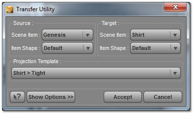

    Here's how I do it in Daz Studio 4.6 Pro except that I also open the "Show Options" in the below dialog and get specific with what I want to do. I'm still in the learning mode, since I get very little time to play :(
    397 x 237 - 31K

    Unfortunately, in Daz Studio 4.6, I can't get the transfer utility to work for my bodysuit for V4. In the transfer utility dialogue box, it has menus for Source/Scene Item and for Target/Scene Item. I have loaded the V4 development rig in the scene and imported my obj of my bodysuit at the correct scale. When I try to use the transfer utility, the V4 development rig does not show up as an option in the Source or Target menus. I tried again with the base V4.2 in the scene. It did not appear in the transfer utility menus. I tried again with a V4 character I had made. Still no luck.
    (in the online tutorial, step 4 copied below does not work because the V4 figure is not an option even though it has been loaded in the scene as instructed by step 1).
    Step 4 : Transfer Rigging Information
    Launch the Transfer Utility dialog, by choosing Edit > Object > Transfer Utility...
    Select Genesis as the Source : Scene Item
    Select your object as the Target : Scene Item
    Select the type of content it is, from the Projection Template drop-down
    Click the Accept button.
    Post edited by Diomede on

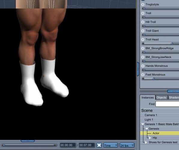

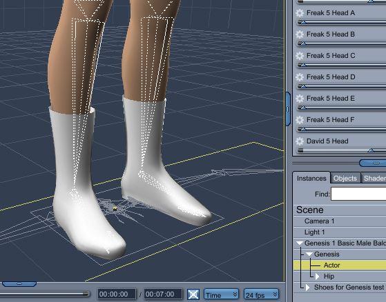

    Thanks to Dart, Headwax, and Evil, I have successfully used Carrara and Studio to make conformable (in both programs)
    - test bodysuit for V4
    - test boots for Genesis (and it morphs reasonably well when Genesis morphs)
    and I can fix spikeys using the joint tools in Poser
    Woohoo. More tools in my toolbox.
    632 x 530 - 43K
    559 x 438 - 56K

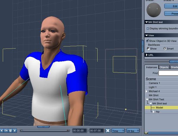

    Thanks Roygee. I did a quick test by making a simple shirt for M4 and applying strange torso poses. That 3 step method you provided worked fine in Carrara 8.5 after I saved the shirt back out as a figure asset in .duf format. It did not work in Poser when I tried to save it out as a cr2 file (figure exploded), but there could be a lot of reasons on my end for that.
    Much better. Muchas gracias.
    697 x 533 - 59K
