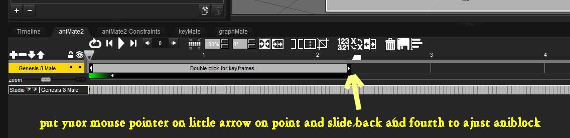

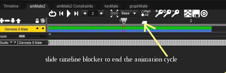

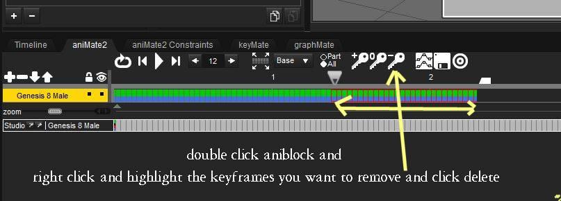

    Yes there are at least 4 ways you can trim aniblocks
    Just beware that when triming aniblocks and rejoining with a new aniblocks may require some reajustments  to get the alignment right.. and that will be best done using keymate to make the animation cycle seem more seemless
    1136 x 275 - 47K
    807 x 290 - 39K
    723 x 233 - 28K
