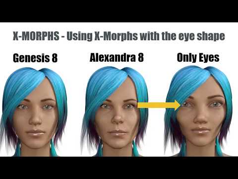

    Try
    And with the smoothing you can choose how much eye area to cover.
    And for more information.
    https://www.daz3d.com/forums/discussion/248176/x-morphs-divide-combine-and-save-released-commercial

    CGI3DM said:
    Try
    Thank you; there's only a problem (my fault, I forgot to tell it!): I'm working on Genesis 2 male, in the materials tab I have "Eyelashes, Eye Reflection, Irises, Pupils, Sclera, Lacrimals", so as you can see there's some difference with what you indicated me (Genesis 3/8?). Okay, I'll try to use these parameters and see how it works.
