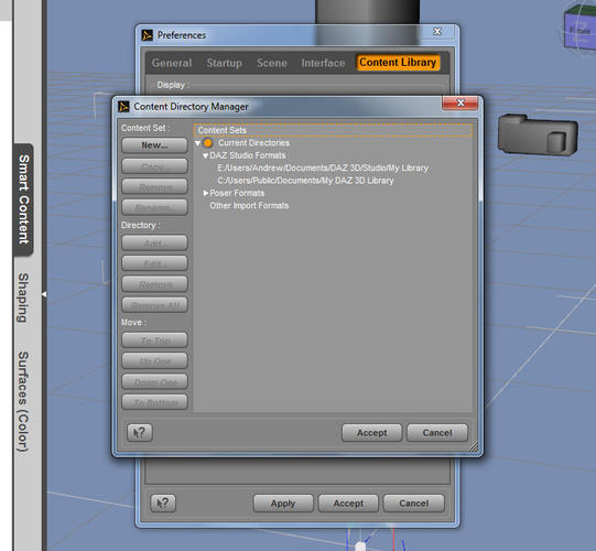

Using DIm to install files to my E drive where my Studio is installed.

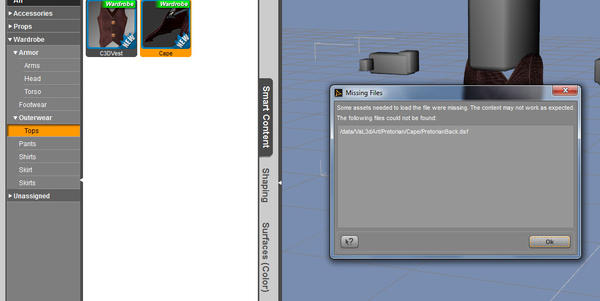

I downloaded Pretorian, when I go to use it I get "The following files could not be found" and then the name and directory of the offending dsf file.

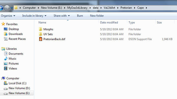

The file exists on the hard drive.
I have my preferences set so the content sets point to my e drive.

    From the screen shot it looks like you need to map: "E;/MyDaz3dLibrary"
    You can do this by right clicking on "DAZ Studio Formats" and selecting "Add a Base Directory..." and then navigating to the above directory.
    Thank you so much DAZ_cjones!
    Fixed the problem,
    really appreciate the fast reply!
