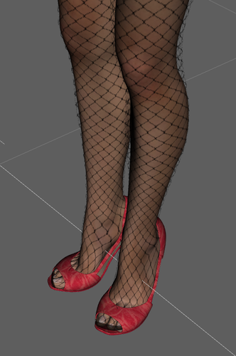

deeahr2169deeahr2169 Posts: 497
Must be something that can be done but its beyond me. Every V4 figure i apply stockings to looks a baggy saggy mess. Well that exagerates things of course, but they never fit properly, even if i apply the smoothing tool, there is still an element of oversize to stockings. Its noticeable, particularly when shoes are worn. This example is not so bad for shoes but note how baggy the stockings are on the legs.
So how can this basic irritation be rectified, anyone have any answers please?

    Could you apply the texture from the stockings to the figure's texture using the L.I.E. or is the mapping too dissimilar?
    Of course this wouldn't work on the toe area, but overlaying a texture on the legs would at least make the stockings follow the legs.

    Here's applying the stocking texture to feet and legs with Layered Image Editor. (The edges and the toes are weak
