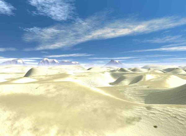

Hello,
I have just completed David Brinnen's tutorial on Bryce desert landscape and have a question about the final image. On the dunes there is a grey colour that I'd like to get rid of. I can adjust the colour but I can't seem to tone it down. Any ideas? Thanks

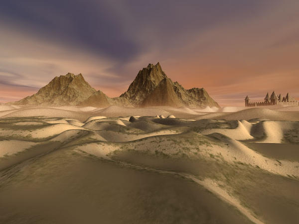

    I also did this tutorial a long time ago. Try using a different sky preset or settings. I had a similar problem too.
    720 x 540 - 50K

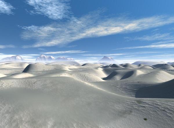

    Hi Chohole. I didn't have gamma correction enable so I rendered the same image with gamma correction enabled just to see the difference.

    Hi Mermaid010. I was hoping for a more realistic look but I like the look of your result.

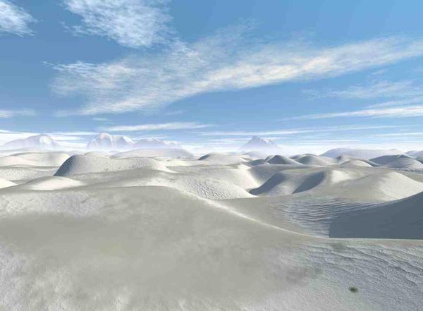

    Hi TheSavage64, I played around with the Sky dome colours and came up with a few options.
    The first image is haze reduced to 3 and sky dome colour changed to pastel yellow, the 2nd image is with Gamma correction switched on and the 3rd image is with skydome colour as pastel yellow with no change to haze settings.
