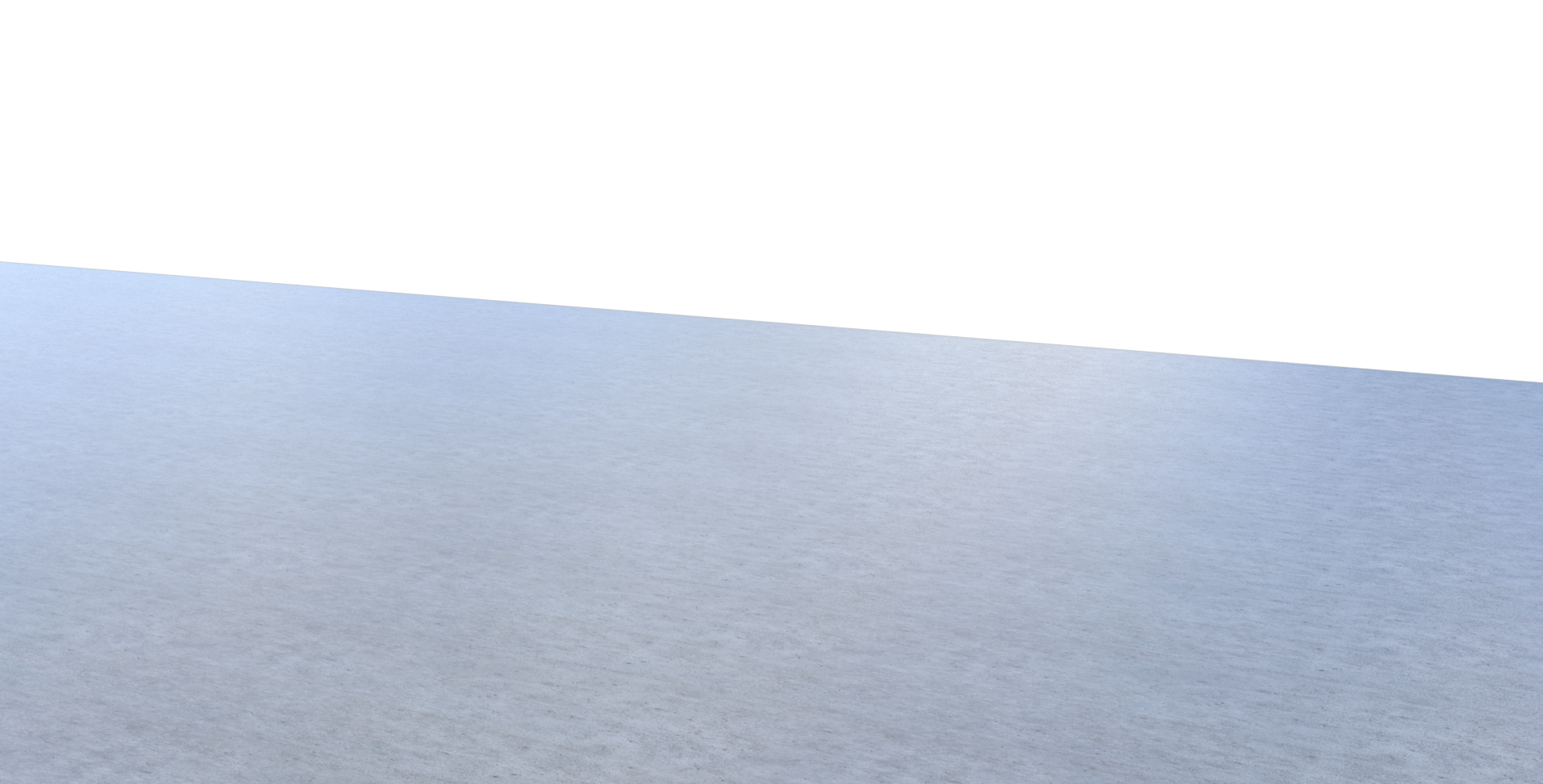

I verified that Draw ground was set to "on" and ground shadow intensity at 1. But when I render the image, I just have the grey "transparent" background, and no shadow. That's what I always see when I render an image without a background. For instance here's what one of my figures looks like (hastily dressed to follow the forum's rules) : in fact, the transparent background is grey when I render, white when I save it to a folder, and black in this forum for some reason but in any case, there's nothing more than this transparent background, and in particular no shadow.
OK, so I was mistaken. Even though the shadow doesn't appear during the render or when I open the file normally, it does when I open it in a 3d software. The reason why I didn't notice it previously was that the "ground" where my figures are staying is significantly higher that the "real" ground, so the shadow was below my frame (first image). I guess that in theory I could lower "my" ground to the level of the real ground, but "my" ground being dark and metallic, I'm not sure it would actually appear. In fact I'm not sure if the "shadows" appearing on my ground are actually shadows, or a blurred and dark reflection (maybe both, second image).
In any case, I solved the problem by doing renders with and without the ground, and cutting ands assembling them so that the part of the ground where the shadow is is kept while the rest of the ground that would hide props and other figures isn't. It's not perfect because there's a difference of lighting of the figures' skin between the "with ground" and "without ground" renders and also a difference in the tone of the ground itself between the first first layer with the complete ground and the bits of ground from the other layers, so one can notice where I made the cuts and paste. Still, it's not as noticeable as the absence of shadow/reflection, and it's not like my image is otherwise perfect anyway.
