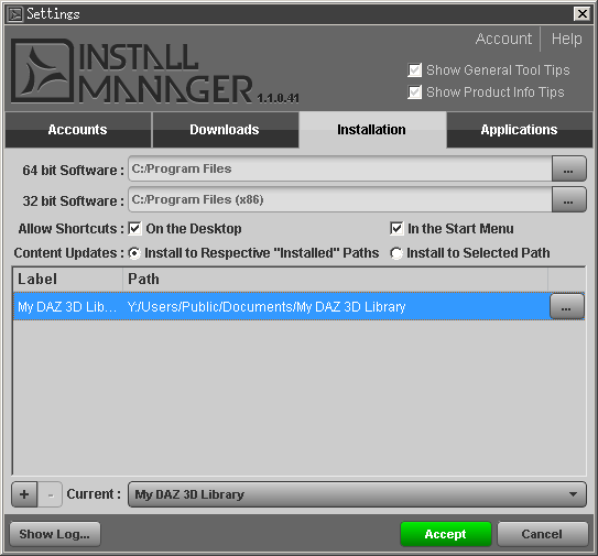

    DAZ Studio and the DIM do not communicate in any way. You will need to tell DIM where to install any new content, by going to the little 'gear' icon at the top right of the Interface, and adding the new path under the Installation tab.
    If DAZ Studio is installed to a different drive, you will have to change the path in the Applications tab as well.
    The install Manager keeps all of it's Downloads and Manifest files in C:\Users\Public\Documents\DAZ 3D\InstallManager, and that would need to be copied over as well.

    I just wanted to clarify your last line, once you add the new path under the Installation tab will DIM still load stuff into the C:...\InstallManager folder or will it go into the new path?
    When you are installing DAZ Studio, I believe that the Install Manager files will be put into a 'DAZ 3D' folder inside the same folder as your content library is stored.
    I am not certain of that, someone else may know for sure if you hang on.
    You should backup any files in the DAZ 3D/InstallManager folder, and put them wherever the DIM files are installed to.

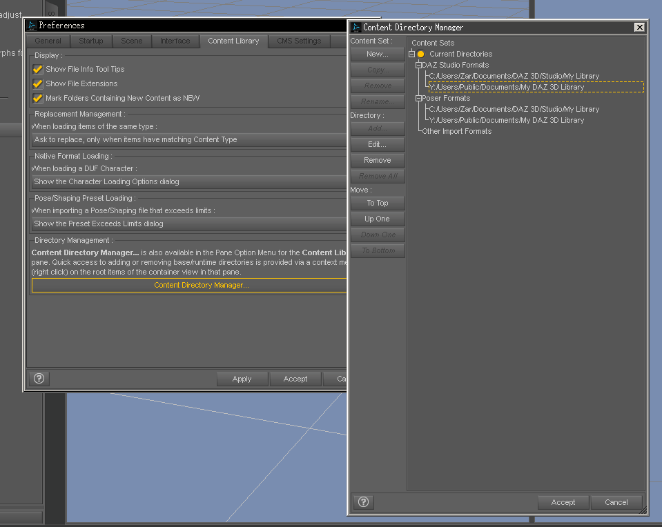

    First if you pointed Daz Studio to the new "F drive" folders, and it is still showing nothing, then CMS has probably turned itself into a pretzel. Simply deleting folders/files with the file-manager (My Computer) with Daz Studio running can do this. Made that mistake.
    http://www.daz3d.com/forums/viewreply/590210/
    Follow her advice and her links in the next post...

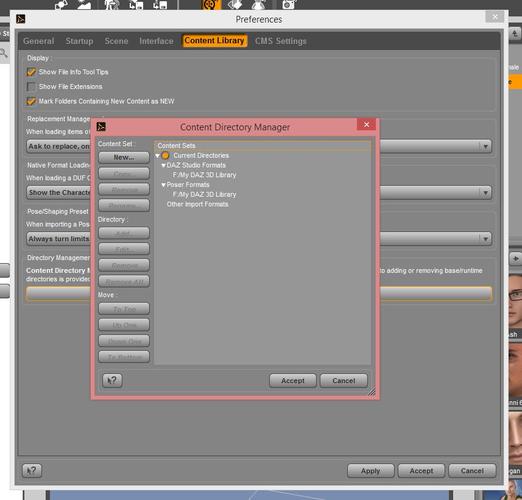

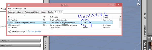

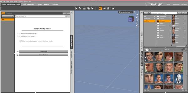

    I moved the folder "My DAZ 3D Library" from the default C-drive to a new place in the root of my F-drive.
    Now all my content is gone in the "Smart Content"-window (on the default left side of the screen), but I can still access it from the "Content Library" (on the default right side of the screen). -See attached image.
    After having moved the folder, I changed the settings in the "Content Directory Manager" to the correct destination. See attached image.
    I would really, really like to have the "Smart Content"-window working again...
    -edit-----
    I checked to see if the CMS is running while DS is open, and it does. (See attached image)
    BTW: If I in DS click "F2 -> CMS Settings" - I have NOT changed anything here! SHould I?
    1092 x 364 - 68K
    857 x 821 - 87K
    1909 x 946 - 181K

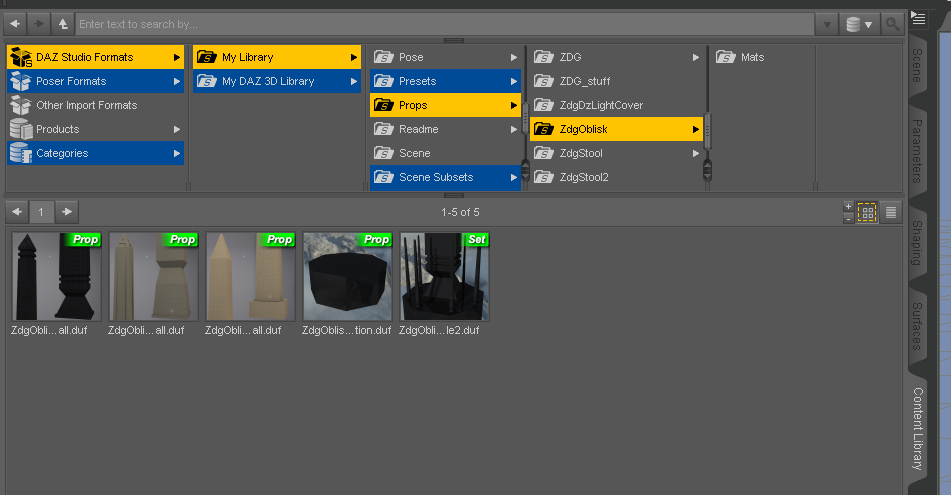

    If you are done moving folders...
    (EDIT; Check my next post first before doing this, the database may be corrupted)
    1 Bring up the menu from the "Content Library" tab. That little thing with the triangle and lines.
    2 Select "Content DB Maintenance..."
    3 check off the "Re-Import Metadata..."
    4 Click accept, then let it think. It may take some time to rebuild the database.

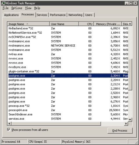

    I don't see anything under "All", do you have a database running, not just the CMS?
    postgres.exe
    There should be many of them running.
    548 x 573 - 14K

    YES!!!
    All I needed was to re-import the database. Now my Smart Content is back!!!
    THANK YOU SO MUCH!!!
