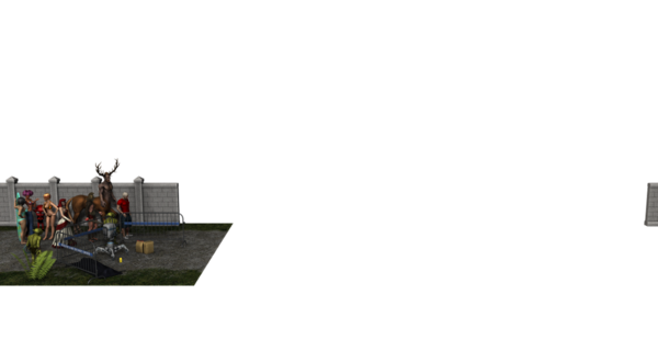

    As I mentioned earlier I have built images from several renders that I assembled into a final image in postwork, using GIMP in my case. Below is one that I have along with the main images (in my next couple of posts) used to create the final image. This was created for the last PA wallpaper contest (Jan 2012) as a banner for the relaunched contest that was supposed to happen after the website relaunch but it never happened. The full final image is 2400x1280 as per the contest rules and I took first place in the contest but as the PA Wallpaper contest never came back my image was never used.
    This was done on my current machine, an Intel Q8200 (a 2.33GHz Quad Core) with 4Gb of RAM, far from cutting edge. Loading and working with these files did cause the machine to slow down noticeably but it was still perfectly usable. It should also be noted that the figure groups in the images where often assembled as separate groups of 2 or 3 figures that where saved then later merged into the large groups you see rendered in my next post along with a few more details.
    1600 x 853 - 588K
    Post edited by Kinich on
  • KinichKinich Posts: 941

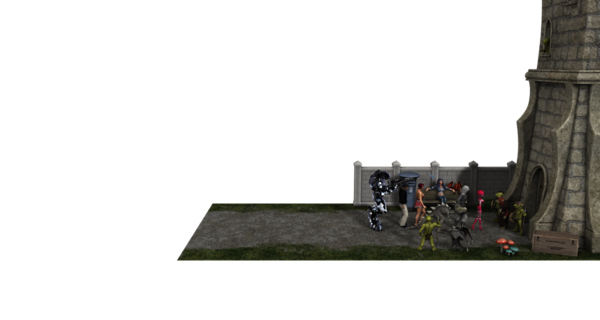

    Following on from my previous post:
    I started by building the basic structure of the image, the canal, path wall & tower then positioning & locking the main camera and setting up the lighting (an uberenvironment sphere in this case). This was saved and then loaded as required to position figure groups on it, deleting segments that where not wanted in individual renders.
    The figure groups where posed as small groups on a single section of path, attached to a null, the path section was then deleted and the scene was saved.
    I would then load the main image, delete the unwanted sections (water, wall & path sections etc) leaving an overlapping section of path & wall to help blend into the next image, merge in the required figure groups and reposition them. Then I saved the scene with a new file name before rendering and saving the image as a PNG file, to preserve the transparency.
    Repeat as required then load the images as layers in your preferred image editor (I use GIMP) and then I erased parts of the overlaps to get the final image, adding a background, effects & text to produce the final image. Note that the individual images contain elements of the next image to make the blending as easy as possible.
    Note, the separate parts below are PNG files (1000 pixels wide rather than the full 2400) so retain their transparency. If anybody wishes to use these to play around with the blending method then please feel free to do so but please do not repost or distribute the files, claim as your own etc.
    The exception is if you wish to post your efforts here in this thread to show off your work.
    Thanks.
    You will need to add a background of some sort, and any other elements that you wish.
    As the maximum number of images per post is 5 I attached the final couple of images in the next post
    1000 x 533 - 122K
    1000 x 533 - 211K
    1000 x 533 - 288K
    1000 x 533 - 277K
