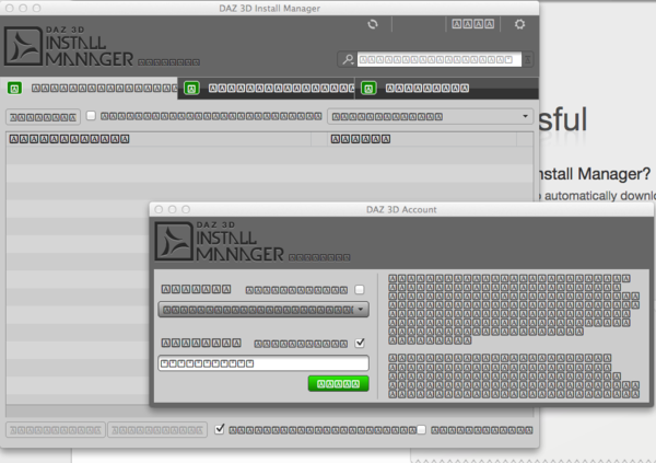

    Hello, I'm having quite a problem with DIM: installed yesterday last version, on Mac OsX Mavericks; the picture shows what I obtained. I already tried to run again the installer (deleting previous installation), but nothing changed. Suggestions?
    Thanks to all in advance for any answer
    Are you running your system with some special systems language (Like any UTF-16/32 system) settings or are you using some kind of font management tool?
    I run DIM in Mavericks with no problem, and what you are seeing is the result of qt (which is the library DIM is built on) trying to find the letters of the fonts and the Fontmanager returns something that is bad.

  • RuthvenRuthven Posts: 699
    Hi Totte,
    I'm running the System in Italian, not applying other particular settings. I have the Lynotipe FontExplorer X application running since startup. I'll try to stop it and restart, and see if something changes, I'll let you know, thank you!
  • TotteTotte Posts: 15,110
    wolfrose said:
    Hi Totte,
    Italian is not a problem (Chinese or Korean could maybe have been), but FontExplorer X is my best guess for a troublemaker.
    Totte, you were right. After restarting without FontExplorer running DIM is working again normally. Thank you and have a lovely weekend!
