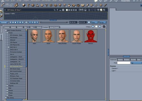

    I'm not sure if this will answer your questions or not. I can only tell you how my system is set up. Because I have Poser, I did download the DSON for poser files to get Genesis to work in that program. To be honest, it is very rare that I open Poser now - it is primarily just used as a plug-in for Carrara when I want to drape some cloth.
    Poser and DSON aside, all of my old content has worked in Carrara thus far. I allowed the DIM to install all of my content, both new and old, to its default directory (if you skim the forum, you will see that that might not have been very wise of me). In any case, when I open Carrara, the browser on the bottom of my screen (note - the bottom drawer has tabs for the sequencer and for content - choose content), I can open the browser portion and find two directories (actually more), one called DAZ Content Runtime, and one called My Library. If I open the portion called DAZ Content Runtime, there are subfolders for Faces, Figures, Hair, Hands, Poses, and Props, that correspond to Poser file types as if it was a Poser Runtime directory. In the attached pic, I have opened the "faces" subfolder, and you will see that my old content for Michael 2 (M2) character heads is still available.
    This setup might not correspond to your own if you downloaded your content to other directories. You can add other content folders that you have by clicking the "runtime icon" in the upper right of the browser tray. The incon doesn't say "runtime, it looks like a black circle that contains the white outline of a page with one corner turned. If you know where you downloaded your content, you can use that tab to create a runtime for that directory. Otherwise, you can use the tab to get Carrara to autodetect content runtimes.
    I hope that I correctly understood your question, and that this helps.
    Ooops, here is the picture of the browser tray.
    1001 x 714 - 102K
