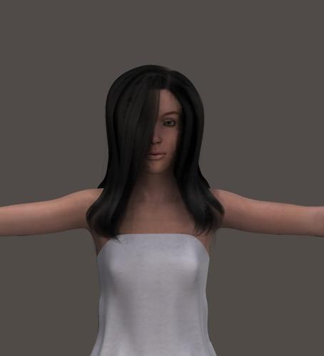

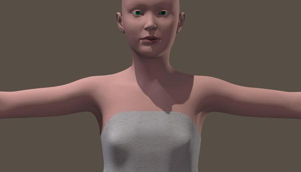

Hi, I need a little help or some hints.
Here is Laura 3 in Poser 9.
1 - She has no eyebrows. Maybe I need to adjust her eyebrow materials
2 - Weird shadow on the left side/cheek of her face near her hair. Maybe I need to adjust the shadows or raytracing settings
3 - her white top doesn't fit around her upper chest. I guess I need to add some morphs somehow. I did conform the top to the figure though.
I just wanted to compare the Firefly render against Daz Studio's 3Delight.
ok, I'm going to read the reference manual after dinner.

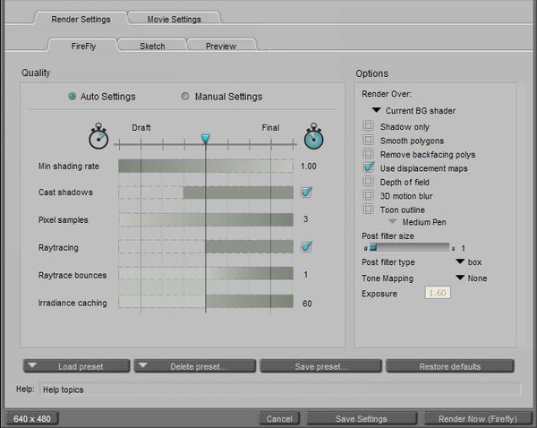

Edit: I forgot to post a screenshot of the render settings.

  • starionwolfstarionwolf Posts: 3,670
    edited September 2013
    i just realized that i forgot to apply Laura's default texture. Adding a texture might solve issue number one and perhaps number two.
    I'm too sleepy to play with Poser 9 tonight. I will try playing with Poser tomorrow morning. I guess I'm so used to the Generation 4 figures that automatically apply a texture when I load them from the content library.

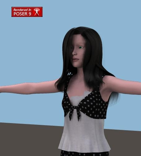

    That is the default shape.
    I created a new scene from scratch. The top looks fine when I do not conform the shirt to Laura. Maybe I should parent the shirt to Laura somehow. Or am I attempting to conform the top the wrong way? I was following the instructions in the reference manual using "Figure" -> "Conform To...". I think that is the right way.
    The top is from Trendy Fasion.
    Here is how the top looks before I conform it to Laura.
    478 x 526 - 26K

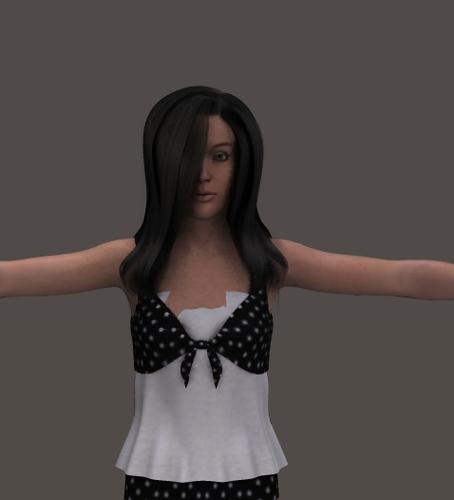

  • WandWWandW Posts: 2,910
    Select the body of the top, and on the Properties Tab check "Match End Points when Conforming". If it's not there, you need to install the latest Service Release 3.1...
    http://poser.smithmicro.com/poser9-updates.html
    1474 x 843 - 32K
    Post edited by WandW on
    edited October 2013
    Thank you! I did not read anything about "Match End Points when Conforming." The top fits perfectly now. I'm going to play with Poser 9 some more after I receive my new hard drive.
