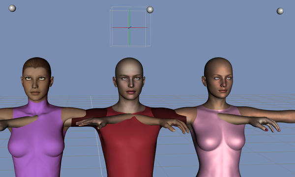

Back in the Mil4 days there was this trick of using DAZ Studio's "point at" feature (usually at a null or low-poly primitive for easier fine-tuning) to make a figure's eyes look naturally in the needed direction. This stopped working well with Genesis -- the eyes still tracked fine, but the appropriate eyelid morphs didn't follow the way they did with the Mil4s. G2F being touted as such an improvement over Genesis I was hoping we'd get this back, but as can be seen from my V4-G1-G2F tests below? No dice.
I don't remember hearing any complaints about this -- have I been missing them, or is this not as useful a feature to others as it was to me? 'Cause I'd really like to have it back.

    There is a script to do that at http://www.sharecg.com/v/67748/view/8/Script/PointAt-Fixer-for-Genesis-eyes
    ..someone mentioned that it works on g2f if you change the object name in the scipt to Genesis2Female

  • KickAir 8PKickAir 8P Posts: 1,865
    Yeeps! Sorry, didn't get a reply-notification on this -- thanks!
    I was hoping for a DAZ-side solution, but I'll take what I can get. Appreciate your help!
