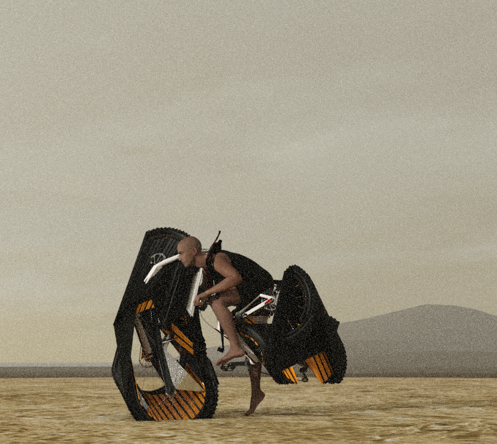

    strange. i started a new scene...loaded G8M ..then the wearable bike..posed..AOK ... then loaded ground stuff... prior I had loaded ground before G8M ... something interfering, not sure what.
    Just so you can see, here is how the bike explodes

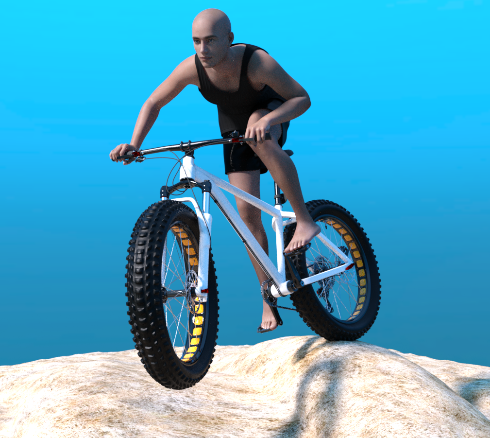

    correct bike and male pose .. finally :)
    That almost looks like the sort of thing that happens when a dforce simulation goes wrong. Any chance of that?
    no... I didn't touch that at all... but you're right on the look for sure.  I guess I'm going to have to load the other stuff 1st and see if it happens again.

    You could actually get the bike and rider all set up solo and save it as a scene and then merge it into the other scene. I do this all the time, especially for complex scenes.

    Hi Daveso! Glad to see you got the poses working. I was just alerted to your problem and came in to see if I could help, but it looks like it's all as it should be...other than that weird exploding bike.... Not sure what went wrong there. It certainly didn't do any of that when I built the set. Nor did it happen during testing (otherwise Jen would have crawled all over me to fix it! Lol!!)
    In future, you need to remember to select your figure (in this case Genesis 8 Male) before applying the wearable preset, otherwise the hierarchical pose presets (the poses that work on both the figure and the prop) won't work correctly. As for the exploding bike render, I can only guess that DS decided to rebel for whatever reason. Possibly a dForce preset was activated on the bike? Or maybe space aliens? Lol.
