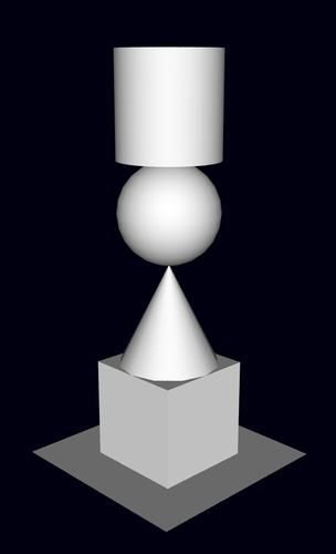

it's a very simple script which can save you a few seconds here and there

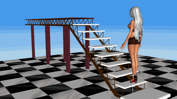

select 2 objects
specify the one you want to be on top
the script will move the other node so that it's precisely under the other ( with a tiny air gap )

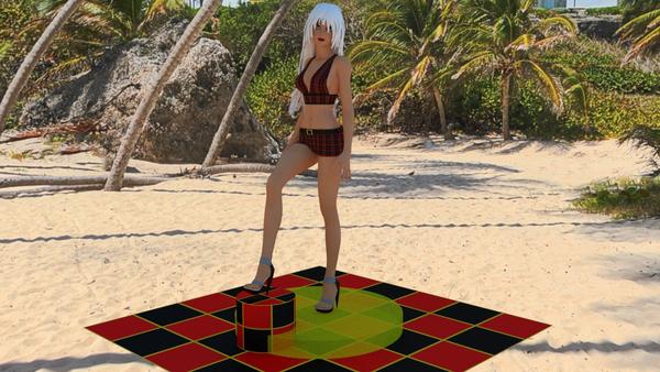

that's how i placed the yellow cylinder under Aiko's shoe sole
how i place the floor under the yellow cylinder
and how i placed the checkered cylinder under her right shoe heel

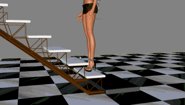

  • RAMWolffRAMWolff Posts: 10,394
    I have questions, I always have questions.
    So if I were to drop a standing figure from up top onto a floor space with a cube that would be just under one of the feet would the IK chains kick in and cause the leg to bend appropriately so that the body would be positioned like the figure in your first post? If so that's going to be a very useful tool!
  • mCasualmCasual Posts: 4,607
    edited October 2013
    the figure pose would not change,
    the top of the imaginary bounding box around the cube
    would just move to
    the bottom imaginary bounding box around the character
    1280 x 720 - 194K
    Post edited by mCasual on

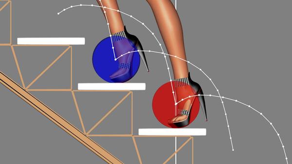

    Ah, but wouldn't it be cool to create a script as I described? It would be a sure fire way of getting feet meets objects, regardless if they are floor level or slightly above that.
    edited October 2013

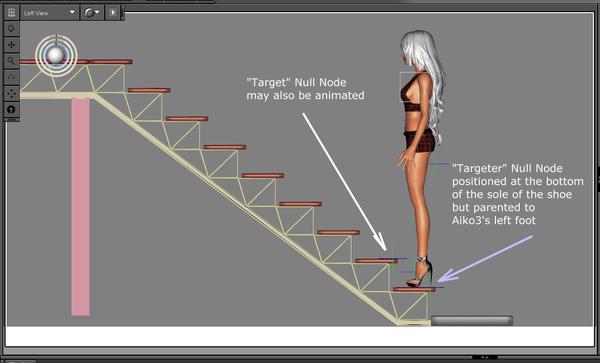

    if you create a null node, parent it to a figure foot
    then move it to the bottom of the shoe sole
    then place a null node on the floor

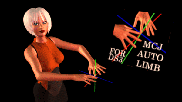

    using mcjAutoLimb can compute for you the
    required shin bend angle
    and the required rotation of the thigh
    to bring the first null-node to the exact location of the second null node
    then you could use mcjKeepOrient to correct the foot orientation
    then maybe use mcjAutoLimb one more time
    https://sites.google.com/site/mcasualsdazscripts/mcjautolimb
    600 x 337 - 333K

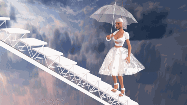

  • nakamuram002nakamuram002 Posts: 827
    I believe what RAMWolf (and I) wants is a mcjPlaceOver option. As an example, it would place a figure's foot on a stair step, then place the other foot (with joint bending) on a higher or lower stair step.
    edited October 2013

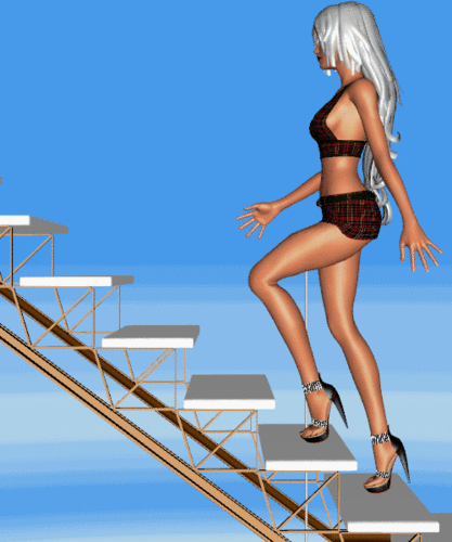

    mcjAutoLimb + mcjKeepOrient
    can be used to create walks, dances and even stairs climbing animations,
    it's not a one-click universal solution but it saved me hours of work and i get steady feet animations
    500 x 600 - 517K
    1280 x 720 - 214K
    600 x 337 - 237K
    640 x 363 - 704K
    1188 x 718 - 78K

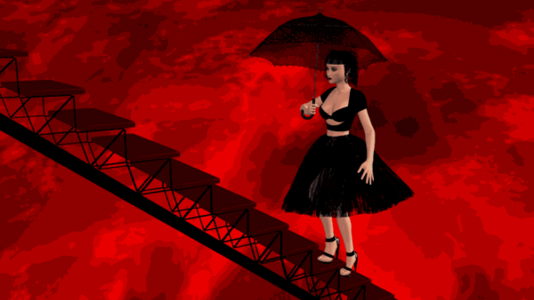

    edited October 2013
    yeah animation takes patience
    i will probably "pull her up" meaning, move her hip node up as much as possible
    which should give her some bounciness
    but if she was a maid holding a plate i could leave it this way
    note that the camera is attached to her hip and it gives the animation an odd look
    but seen from a "normal" camera it looks better
    500 x 600 - 483K

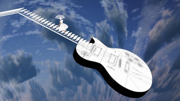

    edited October 2013
    note that there is a place-on top script but it's for objects and whole figures and it doesn't affect the pose of the character
    walk upstairs animation created using
    mcjAutoLimb
    mcjKeepOrient
    mcjMakeTarget
    mcjParent
    blooper
    setInterp
    mcjDecimate
    mcjCycleFilter
    and custon scripts
    1920 x 1080 - 910K
    800 x 450 - 904K
    800 x 450 - 391K
