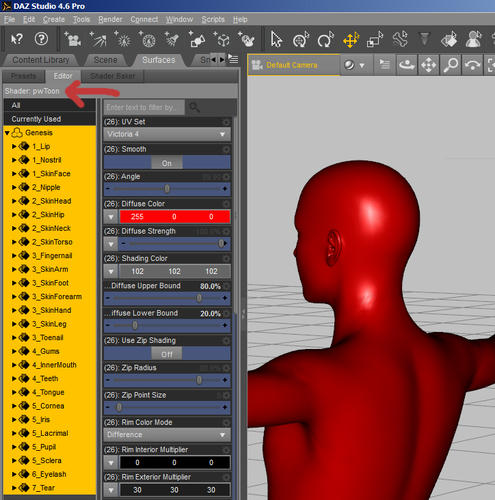

    There is something wrong with your shaders.
    I just tried this. I loaded Genesis, added UberSurface Base from Shader Presets > omnifreaker > UberSurface I then selected Genesis again in the Scene tab, and in the Surfaces tab, and applied pwToon from Shaders > pwToon_DS4 > pwToon Resources > Airbrushed Red.DS, and it works perfectly well.
    You may need to update your shaders to get the latest versions?
    The name in the Surfaces pane changes to Shader: pwToon for all selected surfaces. I am using Win 7, DS 4.6.0.15

  • info_6b436693f7info_6b436693f7 Posts: 0
    OK. Thanks. That's helpful. At least I know I'm doing things correctly. I might try a fresh install of DS 4.6 and pwToon and see what happens. I'll post back with results. Probably tomorrow.
