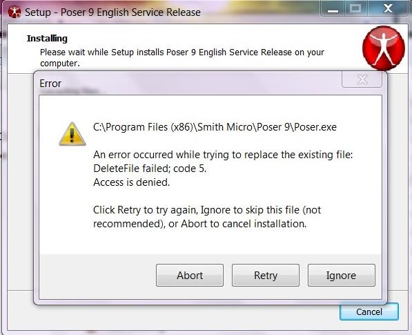

Hi, when trying to install the patch for Poser 9 it shows this
What version of Windows?
Is IE, Poser or anything else open when installing?
Are you running the installer as a regular, limited user or as an administrator?
