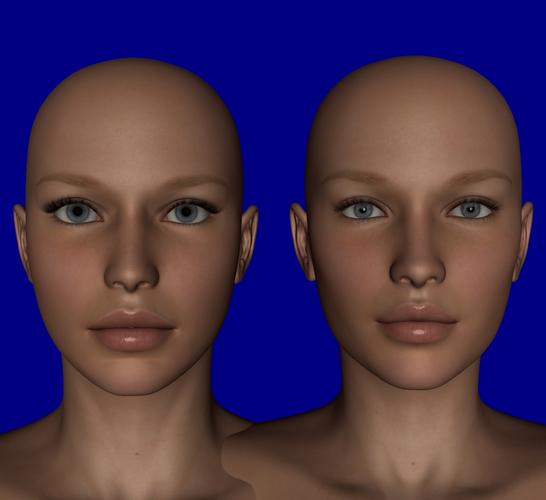

  • Knight22179Knight22179 Posts: 1,195
    Rogerbee said:
    Just out of interest, what is the morph? What does it look like on V4 and what does it look like on Genesis? I think folks might like to see what you're dealing with.
    The morph is Astrid from Rendrosity. The figure on the left is Genesis, the figure on the right is V4. Both have the morph applied along with Astrid's skin texture. As you can see, it barely morphs Genesis even after I've tried following the advice given in this thread.
    1. I loaded V4, morphed the head to Astrid.
    2. I Exported it as a Cr2 and saved it.
    3. Loaded up Genesis, loaded up GenX.
    4. Loaded a new V4 then loaded up the saved Astrid Cr2 and applied the pose so the morph would transfer.
    5. Behold the barely morphed results.
    I've done this kind of thing for Flame for M4 over at Rendro because his morph also would not transfer to Genesis the normal way like Astrid's won't. And with Flame, I managed to get that one to work. But that was a few years ago and I forgot how I did it. I used to have that thread where someone explained to me but I no longer have it ever since the old forums got dumped (and I lost the link). So, I wanted to ask here if this process can be explained to me again because I've done it before.
    689 x 631 - 155K

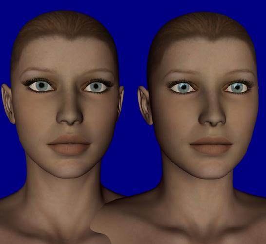

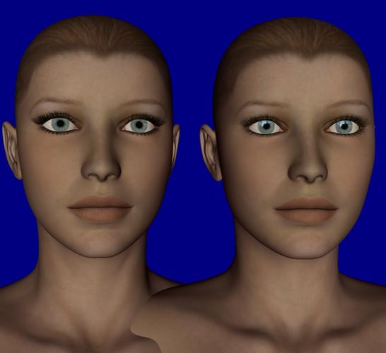

    edited January 2014
    Is the V4 Genesis shape dialed in?
    Yes, she is.
    Are you positive? The figure on the left looks like the base genesis. The neck, nose nor the eyes match up to the V4 shape.
    You can also export the head only as an obj, then load that into an cr2.. That would eliminate any hidden dials in your head morph.
    I'm absolutely positive. Here's two pictures with Genesis on the left, V4 on the right with Genesis dialed in as V4. The second picture is with the Astrid (barely working) morph and both pics have V4's skin texture this time. They look nearly the same to me.
    How do I export the head as an OBJ and load it into a Cr2? And load it into what Cr2?
    689 x 631 - 155K
    689 x 631 - 155K
    Post edited by Knight22179 on
