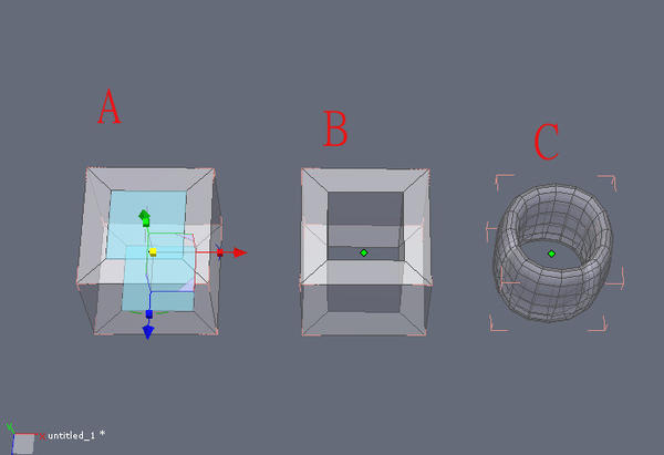

    Here are several suggestions.
    1. The easiest is to fake it by painting a alpha channel "hole" in your texture map.
    2. A method I call "fake Boolean" for want of a better expression. Basically, a perfect square becomes a perfect circle when smoothed. See pic - A extrude inwards on the top and bottom of opposing polys - be sure to get a perfect square. B bridge the two polys - you get a hole. C Smoothed
    3. Delete the polys where you want the hole - draw a circle, extrude it outwards to make a mesh, marry it up to the surrounding mesh, do the same at the other end and bridge..
    4. Start off the mesh with circles, i.e. model around the holes. Extrude them outwards to form meshes, join them up and continue with the rest of the modelling.
    If you need further info on any of these, just ask :)
    697 x 477 - 33K

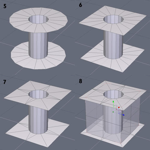

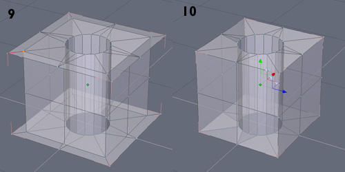

  • polmearpolmear Posts: 33
    Right, here are the steps
    1 - create the model you need a hole in
    2 - make sure there is enough resolution in the mesh, though you could do this with 1 quad
    3 - delete the faces where you want the hole to be
    4 - create a cylinder - this will be the geometry of the hole - size it to suit your needs
    5 - extrude out the edges to make a thred bobbin shape.
    6 - select vertices and scale the relevant dimension to 0, to create a square shape - this step is actually optional, come to think of it
    7 - weld the extra vertices to the centreline or corners, as you wish. Before doing this, add any fillets or chamfers you want.
    8 - weld the hole geometry to your model
    9 - weld the vertices together so the surfaces are stitched together
    10 - ta-dah!
