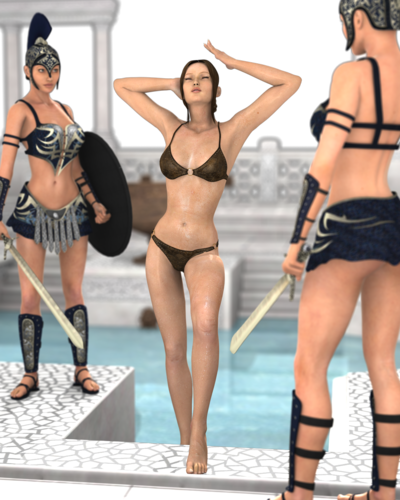

In the first image you see my initial render.
Settings:
Occlusion Strength: 75%
Occlusion Samples: 128
Shadow Bias: .10
shade rate: 8.0 / overall .10
Max Error .01
I then adjusted the depth of field on my camera. The only thing that should be in focus is Victoria coming out of the bath. The centurions and background should be out of focus.

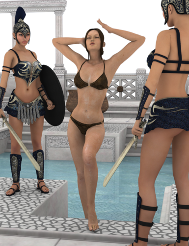

Settings:
Focal Length: 65mm
Focal Distance: 380
F/Stop: 15
But my new render is very grainy where it is supposed to be out-of-focus. I was hoping for something more of a gaussian blur.
Do I need to tweak another setting?

    I lowered the bucket size to 32, and x and y to 12. Looks like it's moving along pretty good. 7 hours in and it's almost half way there. (Image is 1440x2560.) DOF looks nice and blurry, with no graininess. Hopefully it's finished by the time I get home from work. Thanks for the tips.
    Bucket size determines how much data is processed at a time per processor. Having more RAM does not mean you can crank it up, it just means the software has more RAM to work with for any given scene.

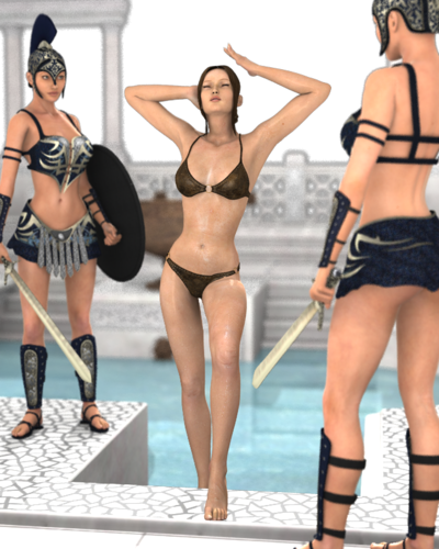

    Awesome! It worked. It looks great.
    Bucket seize: 32
    XY Samples: 24
    Overall shading 0.10
    I went ahead and went back to another render I'm working on and jammed up the DOF too and let it render. Same results. Looks good. I'm not finished with them yet. Still need to do some post work. The Yoga at sunrise needs some bokeh and some lens flare. The greek bath image still needs a background.
