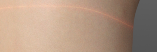

  • Hurdy3DHurdy3D Posts: 1,113
    edited June 2020
    Is this intended?
    On seams I get some kind of glow effect, when I blend different skins.
    In this example I use the Torso and Legs Mask with comes with the product.
    If the mask is bleck on a seam I get this glow effect.
    631 x 208 - 165K
    Post edited by Hurdy3D on
    gerster said:
    Is this intended?
    Do you mean that you have the black mask both edging together there? Or is that the new skin colours?
    At any rate no seams are not supposed to show, check the buffer zone aka seam allowance.
    gerster said:
    Is this intended?
    It's two black mask both edging together.
    Where do I find the buffer zone?
    gerster said:
    gerster said:
    Is this intended?
    Okay, I'll check my files too. The buffer zone is that area all around the entire uvmap. Can be fixed in an image editor. {Keep a copy of the originals as backup}
    edited June 2020
    yeah, googled that about buffer zone.
    I convert the the blended skin via map transfer. There's seems to be an bleed option. But that to 1, but the images still look the same.
    edit: forget that with map transfer. The underyling skin which is NOT transfered via map transfer has this seam glowing effect
  • Oso3DOso3D Posts: 15,129
    Try setting instance optimization to Speed or Memory? Also make sure spectral rendering is off.
    I've experienced some weirdnesses with each of those.
    Okay, glad you found the source of the glow. I haven't tried map transfer {only so many days in the hour} but if 1 is referring to what I think it is, I'd try for 3 or 4 at least.
    Spectral Rendering is off.
    optimization was set to auto, to speed and memory manuelly. Didn't helped.
    edited June 2020
    Okay,
    I removed from the character every morph and hopefully every texture (expect the blendy maks).
    It's defenitly a blendy issue.
    I also attach the duf file.
    1264 x 543 - 977K
    duf
    duf
    blendy issue.duf
    77K
    Well, I didn't find the source of glow.  wink
    But I'm very conviced that's this a blendy or iRay issue. Defenitly not a skin texture, after this issue is still there, after I removed every single texture ;)
    I did a quick test, not seeing the effect. I think your best bet is putting in a ticket, perhaps Customer Service will be more able to address the problem.
    did you used my duf file?
    Huh.
    Ok, this is really nutty.
    The problem isn't blendy, I don't think. The problem is that the transmitted color for your skin surfaces are slightly different (arms and torso seem to be one, then face and legs, etc). Make sure they are all the same color.
    Then the seams vanish.
    Oso3D said:
    Huh.
    uhhh yes... that was the trick!
    The mistake was how I copied the colors. I added the colour now as a custom color and added the custom color to the different surfuces and it's working. Thank you, that was helpfully.
    Oso3D said:
    Huh.
    Okay I think you've earned 'the good detective award' :-)
