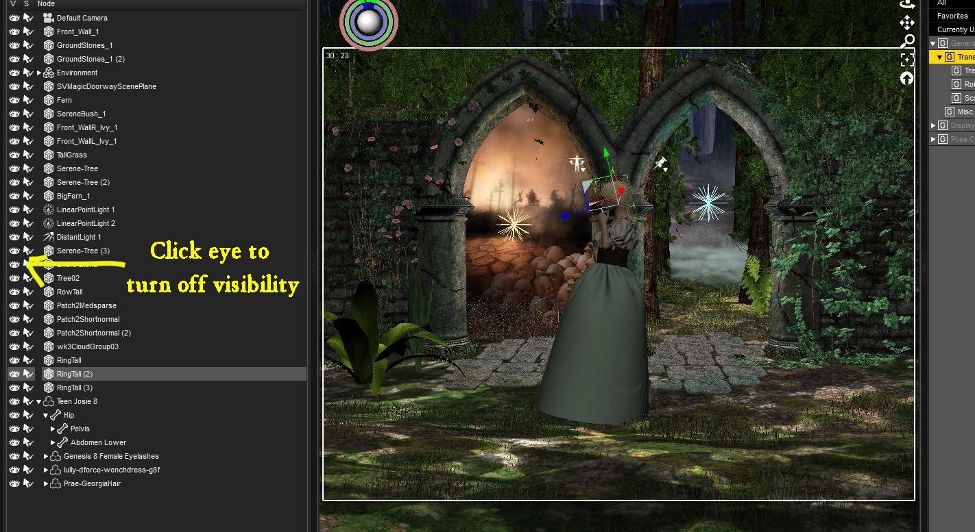

  • IvyIvy Posts: 7,165
    edited November 2018
    I have had the same problem. I think alot of these crash issues are due to having to many items that are set in scene for collision.
    If I have a completely loaded scene and I try to run deforce i end up with a GPU driver crashing every time.
    If I run deforce with nothing in a scene but the character and hair, clothing items I am trying to run in deforce i usually get pretty good results with no crashes unless i have a wind node set to high
    If you can I would start with running deforce & character first and built your scene around the character once you have your deforce clothing complete and saved Other wise. Another method is to shut off the visibility from the simulation that is not needed to be collided in the simluation.
    you can do this by opening you scene tab and click the eye symbol on each item in the scene tab that is not to be used for the clothes & hair to collide with.  this tricks deforce into only seeing the objects turned on. I do not know why this works .. but its a trick  that has worked for me to get deforce up and running with a fully loaded scene. I loaded a capture of how i did it for this render done completely in iray
    1422 x 777 - 220K
    Post edited by Ivy on
