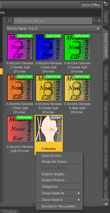

The script will be found in the Scripts category, do you have Filter by Content checked at lower-left of the Smart Content pane? Once you find the script you can right-click on it and select Create Custom Action - that will add the Scripts menu, if needed, and add the script to the menu.
Thank you so much. You right. Now i can see it. I clicked on the script file but "Create Custom Action" option is not there ?
Yes, I was forgetting you need to use Show Asset In sub-menu there to get to the file in the content directory, under Daz Studio Formats, then right-click on that to get the Create Custom Action command.
Thank you Richard. Now is working.
