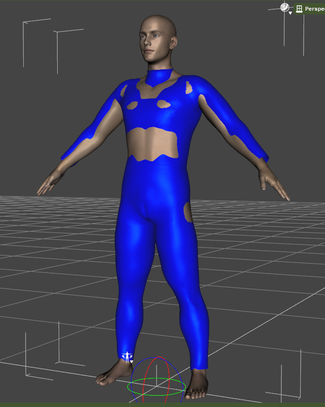

  • RAMWolffRAMWolff Posts: 10,382
    OK, worked but have to say that the auto fit worked better for me than your script.  :-(

  • RiverSoft ArtRiverSoft Art Posts: 6,969
    edited November 2018
    Skin tight type garments are slightly more problematical anyway, but this looks like it is an error in the script.  I hope to fix it this weekend.  If you message me your email, when/if I get a fix, I can send it to you and let you try it.
    edited December 2018
    Ok, it is converting.  But if it is exactly like your picture from above:
    Then the fix is NOT getting called (the sleeves would fit much better).  I would search your system for multiple versions of RSGenesisClothingConversionFunctions.dse.  One of the old ones is being called.
    OK, just showing one file. See the screen grab...
    803 x 69 - 6K
    I think I know what happened now.. the fix you uploaded here was not named RSGenesisClothingConversionFunctions.dse, it was some numerical bit.  So now I've renamed the file to RSGenesisClothingConversionFunctions.dse and placed the old one on the desktop.  i'll run the script again and see if it's working as expected now...
    Works fine now but one thing I'm noticing.. the sleeves and the ankles and I'm guessing the rest of the suit is sort of loose on the figure!  Should be skin tight...
    See the screen grab below.. I set the opacity slight down on the forearm surface settings to show what I'm talking about...
    970 x 838 - 294K
