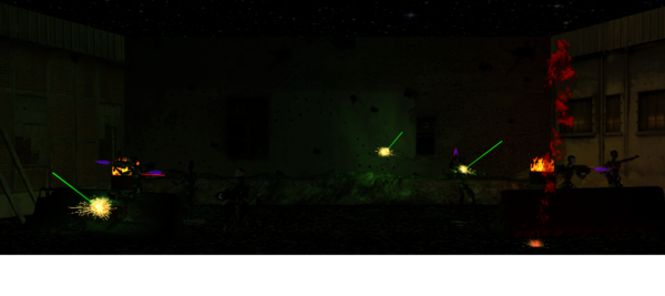

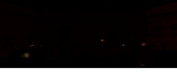

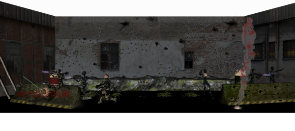

    Here are the versions... Unlit "Preview" render, Hardware Acc, Hardware Acc with Script and 3DLight

  • JaderailJaderail Posts: 0
    Your Ambient, fill light, Is set way to high. You need to learn to adjust the Light settings in the Parameters Tab for Standard lights and in the Surfaces Tab for Uber based lights. Tip: Lighting in 3D graphix is the hardest thing to learn when you start. I know it took me months to get that AH HA for some of the harder types of lights.
    Did those attached pics get scrambled? The file names I get when I hover the mouse don't match the order you've described them in. Am I right in saying the bottom one is the preview, and the top one is the full 3Delight render?
    (It's been a long-standing problem ever since the new forums were fixed enough to allow image attachments — the order you attach things in won't necessarily match the order they appear in on the page.)
    Yes, this was my first time uploading pics.
    Uber light? I assume you mean the distance light, if so I didn't use one, I just used point and spot lights, is this perhaps the problem?
