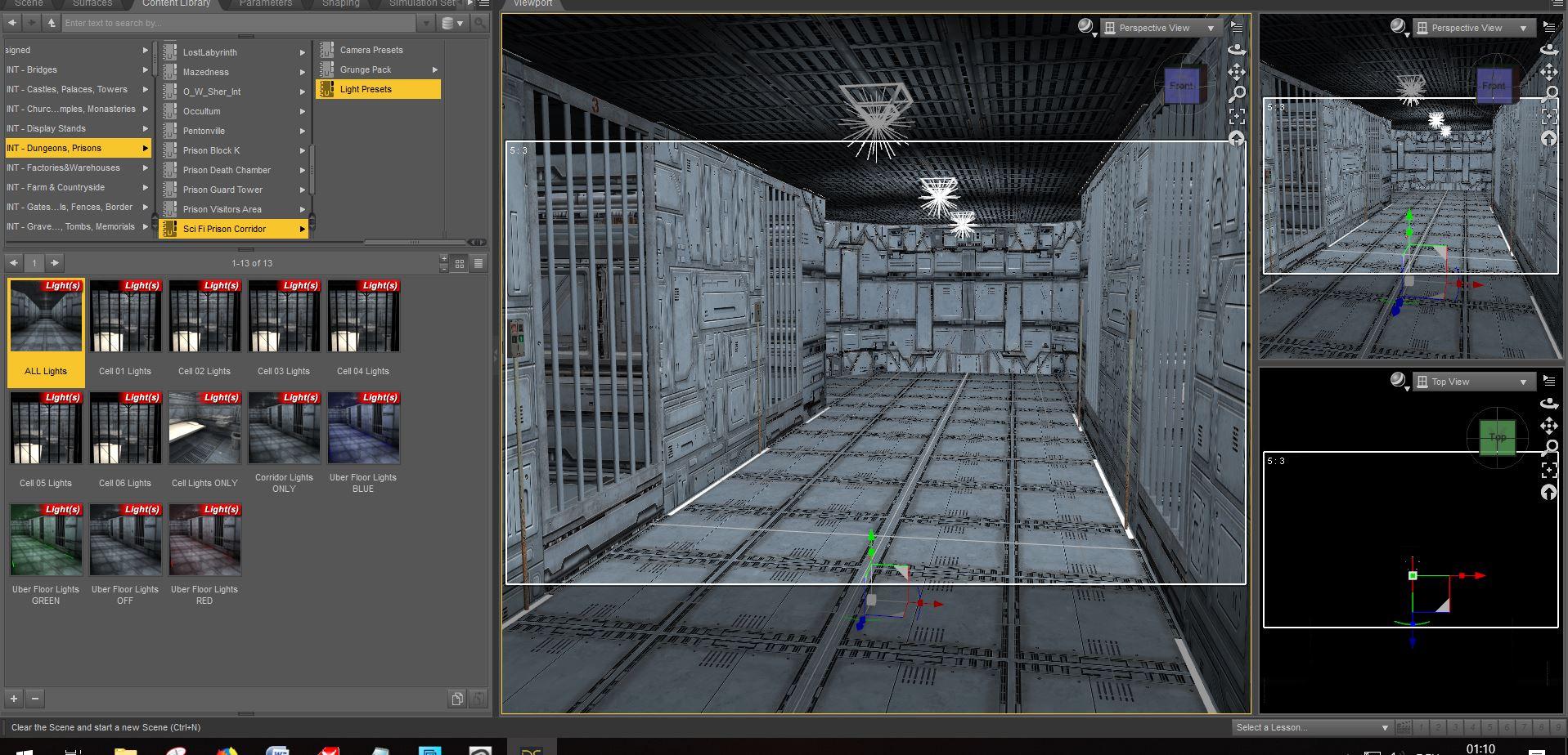

    I have to say that I do not have any problems seeing that set in the preview (unless I use render preview, of course). I'm using the current DS 4.11 Beta, so it might be something that they fixed there?

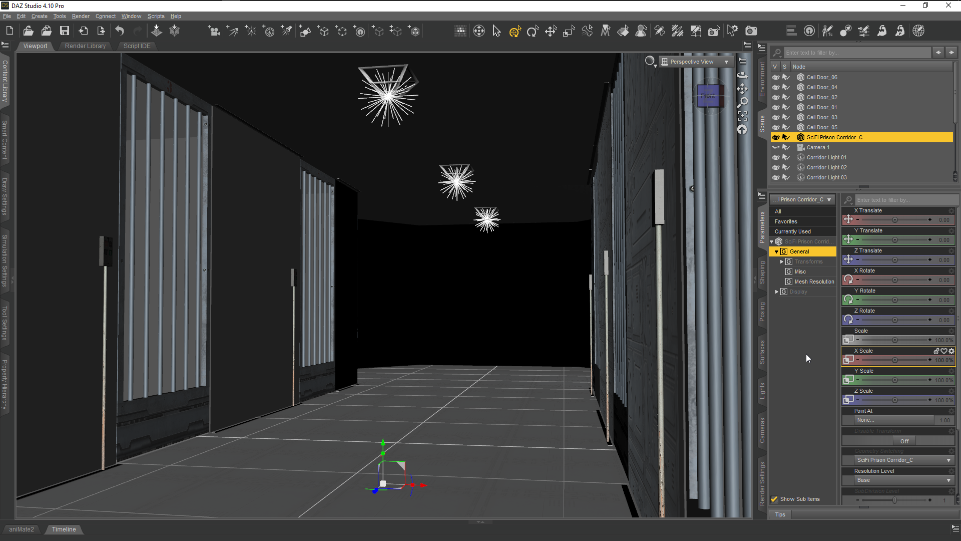

    Looks like it. Here's what I see in DS 4.10, in Perspective View as well as through a Camera with HeadLamp (any mode Auto/On/Off)).
    In DS 4.11 I see the same as you. That's with Backface Lighting set to ON, if I set it to OFF it looks like in 4.10. Setting Backface Lighting to ON makes no difference in 4.10 though.

    I din't try it with this EXACT set, but I tried the headlamp with another set and I also had no change.
    I'm still using 4.10 so....it appears I either need to update or use another set.
    Actually Distant lights seems to work in DS 4.10 as viewport lights (see screenshot). The strange thing is that they seem to light in the opposite direction than the one the point in, so maybe the light is actually caused by reflection of some kind. But it works, the two lights I'm using here lights up everything, even the inside of the cells.
    For rendering I tried to put some small plane mesh lights at the pointed end of the lamps on the ceiling, seems to work fine.
