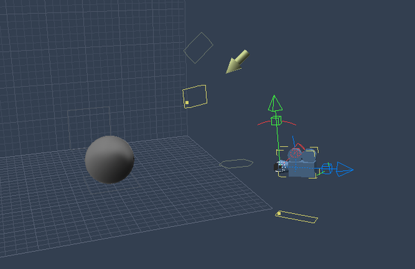

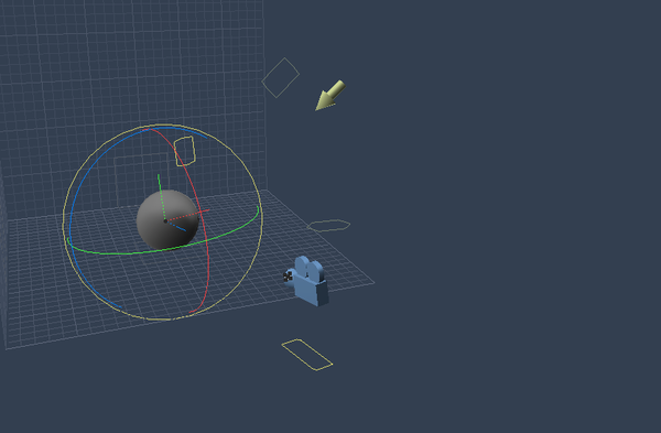

    As mentioned above, the camera does have a hot point. To move the hot point, but not the object (in this case, the camera) make sure your Caps Lock key is enabled and you can move the hot point.
    This is what I do:

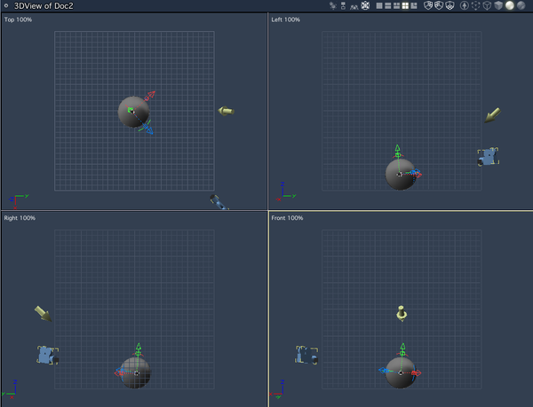

    1) Aim the camera towards the object I want to orbit.
    2) Select my isometric views, such as top, left, right, front, etc.
    3) Enable the caps lock key and using the isometric views center the camera's hot point on the object I wish to orbit. You can do this numerically in the motion tab as well if you want it to be exact. Uncheck the Lock Hot point checkbox, and just make a note of the object's hot point X, Y and Z locations and use those coordinates for the Camera's hot point. When you are done, disable the the Caps Lock button or if done numerically in the motion tab, re-check the Lock Hot Point checkbox..
    4) Now select the rotation manipulator and you can orbit the object.

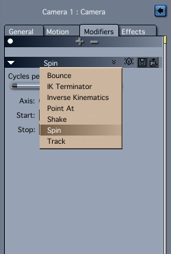

    5) (Optional) Instead of manually orbiting the camera, you could also use a spin modifier on the camera.
