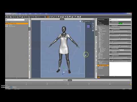

    Here is a video that should help you get the fit you need on most any figure.  This doesn't always work, especially for morph extreme shapes ie: if the figure you want to morph to is way tiny the cloth will be way too big (could be useful for lost waif type renders though!) If you want to save the sim result as a morph you'll want to set mesh resolution back to base, export obj and then load in as a morph in morph loader pro. Please note this video is by no means professional, there is no sound but should give you the basics of using Timeline with dForce to fix mesh crumpling.
    Hm... I didnt get it. You did simulation 3 times. It was 3 different situation? Or It was all necessary steps to fit one t-shirt?
