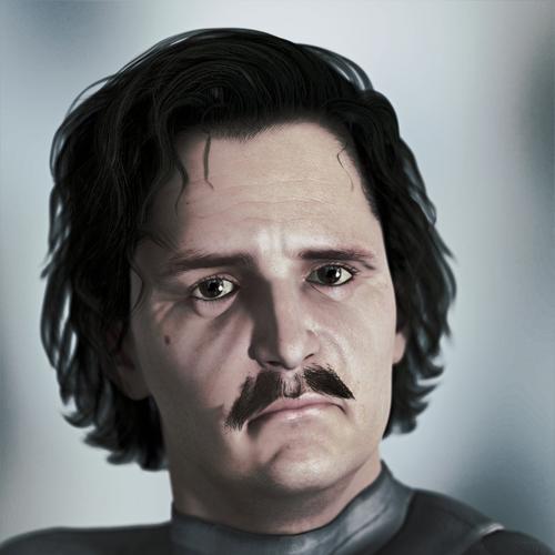

    I've done it in DAZ Studio (assuming you consider Poe a celebrity, that is). As I see it, there are three main methods:
    1. Use a modeling program to make a custom morph. Neither Poser nor DAZ Studio is a modeling program. You could use Hexagon, Carrara, Blender, ZBrush, etc.
    2. Use morph dials to morph the figure's shape into something that appromixates the celebrity's appearance. That's what I did. The more morphs you have access to, the better.
    3. Use d-formers to bend the figure's mesh. This can be done in DAZ Studio (I don't think Poser has the same function, but it may have something similar involving magnets I think). I haven't heard of anyone creating a celebrity face this way. It probably could be done, but I suspect most would find the other methods to be preferable.
    You could also combine two or three of those methods...for instance, combine a custom morph you made (in a modeling program or with d-formers) with other free or purchased morphs.
    I don't personally have experience using Poser. My understanding is that some prefer Poser's interface and others prefer DAZ Studio's, but probably neither would really do a "better job" at this task than the other.
    Poser has magnets which are like Studio's d-formers but with one extra feature, you can edit the fall-off graph of a magnet. That gives you a bit more control. I don't think you can do this with d-formers.
    Some versions of Poser have what they call the Face Room but this only works properly with supported figures. I don't know if Poser 9 has this.
    I have experimented with Faceshop. I got some fairly nice looking faces but they never came out looking like what I was trying for. Perhaps that was because I didn't spend enough time with the application.
    I think you are right in saying neither program is better than the other. Its probably just a case of spending the time to learn how to use the application well.
    P.S. I really like your Poe render, a very impressive bit of morphing.
