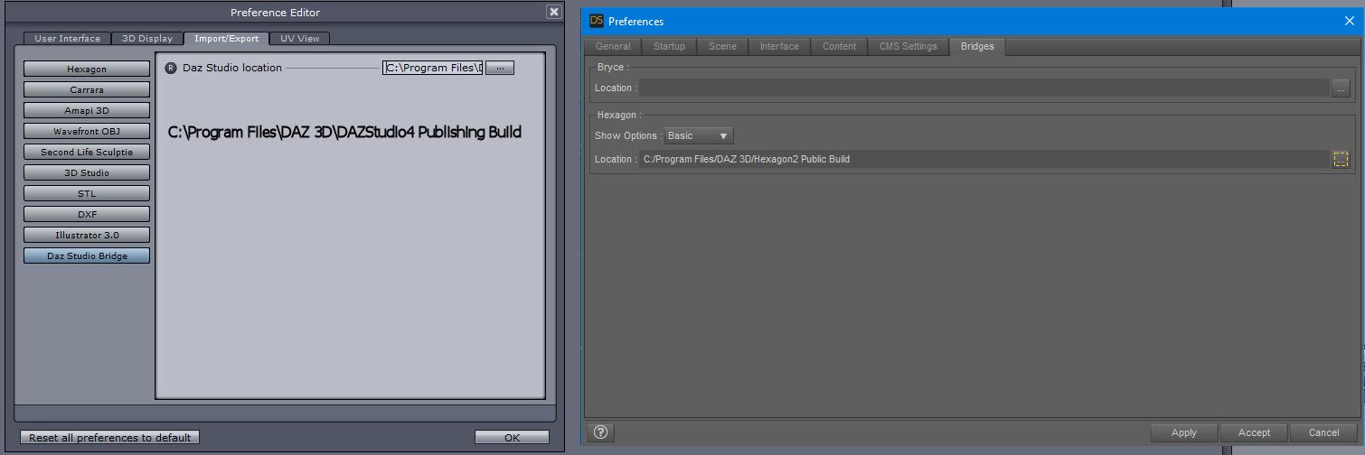

    Just thought I'd nudge in here with a little tip, when DAZ does an update for DAZ Studio or Hexagon you may have to change your preferences in each app for the Hex-DS bridge to work properly. I've done a screen grab of my preferences.
    Like Jonny says, the locatons change if you are using 32 or 64 bit machnes.
    Edit - Took me ages to load this picture properly - Getting old LOL
    1510 x 504 - 252K
