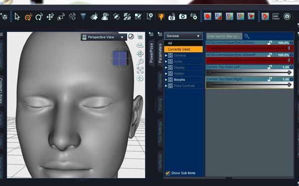

Why genesis leg nail move, when lip pucker, or lip pucker wide?! (first bug solved next one)
kitakoredazkitakoredaz Posts: 3,526
I sent bug reoprted one month ago . and I suggested DAZ need to check once again
then quickly remove bug.
About Young Teen 5 Julie eyelids MCM morphs. I do not hope to check manual installer.
but Actually DIM zip installed files keep problem. and not up-dated still.
If user have insalled Julie, and use
poze controller of head>eyelids Top down (left or light, or both)
All genesis character are auto-defromed by this MCM for Julie.
I suspect if DAZ do not understand the problem clear.
When some Character MCM have no controller setting
to work with Character,
it is not problem only about this product .
if other vendor or user make original morph for each character,
and make MCM for same poze controll,
they also get influence of Julie MCM without intention.
so that this problem should be removed.
even though how many times, vendor needed to up-date about same product.
But DAZ did not correct and did not confirm, I got no response.
and now mantis can not be seen by other user.
I understand DAZ do not like to show many bug reports about contents
to many user, untill DAZ or vendor remove bug.
But it is wrong. DAZ need to show clear, when they found problem.
so that User can correct by themselfs if they hope so. or keep demand DAZ
and vendor to correct bug. or user just ignore , pretend as if there are no problem.
I
I found new product for reallusion iclone5,
this young teens bundle released for iClone too. (maybe with some apendix with easy set up files)
then Did DAZ correct this problem for iclone5? or still keep and leave it off,
or have not noticed problem still?
981 x 612 - 79K
Post edited by kitakoredaz on

  • Richard HaseltineRichard Haseltine Posts: 111,371
    I'll point this out - the MCM isn't being multiplied by the Julie morph(s) as it should be.
  • barbultbarbult Posts: 27,500
    Is there a way for users to correct this for themselves, or do we have to wait for a DAZ fix?
    The fix has been made and is in the queue for the servers, but it probably isn't available yet for download - if you try tomorrow it should be there.
  • kitakoredazkitakoredaz Posts: 3,526
    Hi barbult. Yes.
    Usuall way is use property editor, then make link to set ERC .
    or manually change code of DUF.
    for these MCMs (assigend root node as hidden property)
    MCMJulieHdUpperEyeLidDownL, MCMJulieHdUpperEyeLidDownR
    to work correctly
    they need to set link as child for the PHM (which work with Poze controller,
    and actually change vertices , then make eye lids up , and down for zero shape genesi)
    PHMEyeLidsTopDownL
    PHMEyeLidsTopDownR
    At same time,
    head MCMs need to set link as child for the Character Head morph (in this case,FHMJulieHead)
    for FBM there are another MCM too.
    (I do not know why daz make two perfectly same MCM for Head and Body morph,
    I thought I may use One MCM and set "add" for each character (FBM and FHM)
    then set "multiple", for PHM witch controlled by Poze controller.
    but anyway these MCM set type "add" for PHM alerady,
    and these MCM need to work with head morph,
    Set "mutliple" for Julie head morph "FHMJulieHead"
    Richard thank you.
    but why, DAZ can work so quickly, forum admin or vendor tell the same fact
    and not from one of customer (User) bug report, DAZ can work so quick?
    I perfectly reported same thing, with same more clear pic.
    and I mentioned need to set "multiple" for character morph,
    if user correct it, or DAZ check easy. in the bug report.
    (then it is actually two or three month before, I think)
    So that I think I may need to report not bug custome service. or mantis about Content.
    I may hope to clear discribe here, and show the problem to antoher user.
    nof simply fun of DAZ. even though it offence daz .
    That was speedy. Thanks Richard.

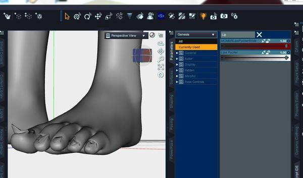

    OK,, I hope someone report DAZ .
    I found this report by other user, before, it was so strange and unusable bug, that
    I believed daz soon remove . but daz just leave it off at current.
    when genesis head poze, lip pucker, or lip pucker wide,
    your genesis leg finger nails move and break,
    (I do not know if there are another more secret strange bug, (DAZ joke?)
    I thought it is simple mistake, but it is strange because,
    all MCM which assigend lip pucker, and lip pucker wide,
    are made to move nail.
    When change only MCMM5LipsPUcker, or MCMM5HdLipsPUcker,
    or MCMHitomiLipsPucker. MCMV5LipsPUcker etc.
    MCMJINLipsPucker, or MCMS5HdLipsPucker.
    to detect which morph cause problem.
    Because these MCM has no Sub components,
    so that if genesis foot nails move, ,it means these morph have problem too.
    Then all these MCM which linked as sub components of PHMlippucker, PHMlippuckerwide
    change genesis leg nail . as same as PHMlip pucker, PHM lip pucker wide.
    Maybe I can understand, why it happend,
    PHMlip pucker, and PHM lip pucker wide have problem individually. they move genesis leg finger nails.
    then vendor make MCM for character with this phm
    I do not know when this problem happend, but they may simply make delta morph from this phm
    then if daz change this phm,, it may cause problem too.
    even though daz up-date about PHMlippucker, and PHMlippuckerwide,
    this problem may not be solved.
    because, when we use other character, (V5 hitomi micheal S5),
    their MCM move nail too.
    Anyway, I can not understand why daz do not check his report, and just leave it off one month more.
    and this bug can not remove by user easy, without you have any 3d tool and it can mix shape.
    1047 x 616 - 71K
  • Cayman StudiosCayman Studios Posts: 1,145
    This Lip Pucker problem is pretty funny. I suppose one reason why it is thought low priority is that there will not be too many pictures where both the lips and the toe nails of the same character will be prominent within the frame, especially one where that character is puckering his lips. :lol:

  • BejaymacBejaymac Posts: 2,002
    The toenail & fingernail issue is a really old one, as it's been there in Genesis right from the start.
    It still raises a laugh amongst the Poser diehards over at Rendo.

    Then DAZ have good technology by mixing and apply original shape, adjust to make new character.
    shape poze, expression, we may can add voice too.
    For those type user, even though the problem can not be seen in render,
    or you can hide the problem for your special works, or you seldom use the poze with your work,
    There is not many meaning.
    which part, the morph effect for eye or, for hip , fro mouse, for gental,teeth, or only use for someguys like pozing,
    if it can not work as expected and designed,
    I feel the character have problem, must hope to correct it.
    then If the bad effect cause from my mistake, I need to concentrate to remove problem.
    serch way. but if it is offered from DAZ, I think DAZ need to remove the problem.
    base genesis, or base gen2F is most important to customize new character by DAZ studio 4.6.
    I get daz pozing or expression , and many character morphs ,
    because customize, and move my new character,and apply more ability for Character.
    as I intention easy in 3d world.
    (I have not choose where is best, I do not care, it is ds, or poser, or icone, or carrara, blender,
    more expensive tool for professional animator, or x box, or ps3, ps4,, etc,,
    if it can move without problem , and not lost detail, I may hope to move in every aprication, which I can get.
    IF I feel to make render for the character, I may do, if I hope to make simple motion and record, I do.
    but those work are not so important for me.
    I know, even though there are many controller for expression, and pozing,
    most case, User need to adjust again to fit original character. it is same about clothings.
    Adjusting JCM MCM for each controller or, reshape geometry of clothing for pozing,
    to wear on character, I can feel content , and enjoy it.
    As for me, ds is tool to making 3D character easy with many variety.
    genesis or morph or poze are materials for making character. not for making good 3d work
    (Art or cheap pic or exciting for someone pic or just hope to show something you did or,,)
    then I bought these promade materials from DAZ to make easy, but if there is clear problem,
    I can not pretend there is no problem.
    I think,, vendor who making character can understand the feeling.
    why DAZ can leave it off genesis problem easy?
    you can feel content, it can be hide, or seldom use, so that, not need to correct?
    if you really do not care, I think, daz is not real vendor for 3d figures.
    your CM is as if your 3d character has life. (I understand it is funny and childlike)
    but Actually many user enjoy to make character, and give emotion, pozing, as if
    they live do not you think so?
    So that DAZ proud your detail of work ? your 3d figure is not simple 3d illusion.
    it is as if live. or your figure is just for guys who like to make photo with model?
    then model is sick or broken, if they can hide the part, you do not care?
