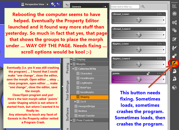

Thought this would be a simple task and 'finally' I would use that Property Editor everybody else [it seems] is using to make adjustments for the placement of a few morphs I was hoping to release. iiiiiieeeee ... what did they do!?
1. Clicking on the Property Editor button crashed the program more often than not.
2. Telling it to be undockable was another immediate crash.
3. okay ... so carefully expanding it to read but not dock ... Click on Genesis ... crash.
4. started to think this must be a game ... how many ways can we crash D/S with this editor.
5. other side, found morph to have place moved ... said it did ... but it had an asterisk [presumably means it didn't save it?] I dunno. Wouldn't let me do anything else.
6. Okay ... had 2 morphs with asterisks [morphs were already made and already saved via the Morph Loader and Save Asset thing] ...
told this Editor to put it under a different folder. Sometimes on the Parameters Tab and inside itself it did appear to do so.
So okay when it looked right, though maybe i should resave the morph(s). Sounded good.
7. open D/S and nope. new morphs not showing.
8. check files ... okay it made a couple new files in the right folder but they do not show up on the tab.
9. the old morphs are still in the first folder ... they work ... but show only where i have manually edited the file for them to show. Had to manually edit the files because the Property Editor appears to be totally borked.
Feel free to jump in and tell me which button I forgot to push. Or why one can't touch "Genesis" or why W7Pro says that D/S4.6 doesn't appear to be working correctly and therefore was closed ... and it changed some settings, oh lordy ... well that was one great upgrade.
This is not the beta but the last general release.

    Thank you ... glad it's not just me, but yes, this needs to be fixed badly then ... I don't have metadata for the morphs I make although it was listing them ... that screen fills the entire monitor ... sure hope it scrolls one day or it's going to be totally useless. Or as you say, I'll have to move morphs out of the directory. or ... return to Notetab Light. It's not a perfect world.

    Well it's nice somebody doesn't think it's borked. Anything that crashes a program instead of doing what it's supposed to comes under my defn of borked.
    Today was a bit better. I made a test morph in the same program so there'd be no "variant file type issues" possible to blame.
    The editor discovered a whole bunch more stuff to put on that group page and it DOES run over the page and all what is off the page is of course "unreachable". That would also come under my defn of borked and needs fixing.
    Did manage to get the tree under Genesis to unfold but could not "touch" anything without the editor crashing the program.
    A naked grey Genesis is 'all' that is in the scene.
    On the plus side, it appears to be in alphabetical order :-)
    Can't install a program that can't be downloaded. [because no thank you, I do not require an installer helper to install programs, I know where they are supposed to be going - or possibly more to the point, where I'm going to install them to].
    Between crashes, I managed to do "2 things" --- "one at a time" with a save file between changes. Didn't clock how long that took, but if somebody wants to make only 2 changes on 20 items, they're going to busy for awhile. Program does load faster if it's not set to open a scene by default. Manually load a Genesis.
    You know, it could be that the professional professionals are taking for granted a little too much knowledge which is why so many of the people who have downloaded the programs aren't getting too far with them because it sure helps to cut the grass if you know where to put the gas ... and in into which lawnmower. The electrical lawnmower will not cut the grass no matter how much gas you give it.
    So in plain English, please, A TUTORIAL FOR THE PROPERTY EDITOR.
    I'm not trying to be difficult. Actually i started out with a "I have a little set of morphs to share, why don't I sort them out right and make a tiny tutorial to show people how easy this is to do." And I proceeded to do that which I had learned from a previous edition ... only to discover things were NOT working as expected. My tutorial idea has been cancelled because somehow I don't think you want me publishing one showing how many times the editor crashed the program while trying to properly edit and move ONE morph.
    CMS appears to up and running just fine.
    AV is not a factor as it is not running.
    Peace.
    edit to clarify. This image have confused a few, sorry. this is the Parameter Tab, not the Property Editor. The property editor is a grey box with 2 sides, tree layout. Same as everybody else's on 4.6.0.18.
    914 x 666 - 114K

    Today using a different, but basically a repeat of what I did the first day ... had the same problem with the morph showing "not moved" and "not coloured" even though the Editor said it had done the task AND yes I have re-saved the morph.
    I went digging manually through the files ... and yes it saves out a new .dsf morph file where I told it to and in appearance looked like it should be working but it wasn't.
    However, it did not do anything with the original morph file which had been created in a previous program.
    Going by what was in the folders, I would have expected BOTH morphs to show on the Parameters Tab but no, only the old one did.
    So I manually removed the old one from the folders.
    Opened D/S4.6.0.18 and yes, there [finally] was the newly saved morph showing up exactly where the properties editor claimed to have moved it, and it was also coloured as specified.
    So, for what it's worth, in 4.6.0.18
    If transferring morphs from one group to another ... select the morph in the Editor, hope the group shows up in the group list, select it, close the Editor! ... then File > Save as > morph asset again. Close D/S. Dig through files manually and remove the old file [somewhere under My Library > Data ....] Open D/S and the new file should be showing reflecting the requested placement change.
    If creating the morph IN 4.6.0.18, after said and done and like oops, want it in another group, Property Editor [when it arrives], select the morph, select the desired group if it shows up on the page, then "Close the Editor", then File > Save As > morph asset again. Close D/S. Open D/S, load figure, select figure, and the new morph should show in its new place on the Parameters Tab.
    It's important to close the Editor before closing D/S so that said tab is not open with D/S is again opened ... you know how long it takes to load, etc.
    n.b. to whoever is the Forum Webmaster ... [.u] [./u] minus the dots, is supposed to be "underline", not "italics".
    note to self: Notetab Light ... it's free and so easy to use. Find file, open it, edit it, close file, close program. Open D/S, file all fixed.
