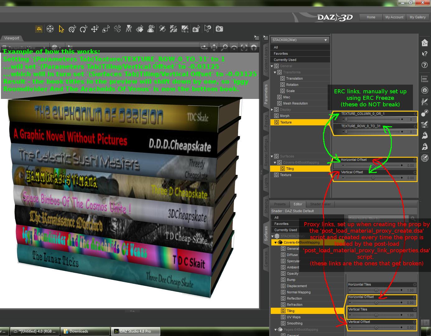

    Anyway, here's an annotated screenshot collage type thing showing how the thing works from a UI POV:
    And here's the2x32 grid of books texture map (from this post on my books freebie thread)
    *while I understand and appreciate the basic idea of OO, for me personally it has always stood for Object Obfuscation when it comes to actual implementations ! wink
    **I'm NOT: because (1) I already use UNIdirectional ERC between the integer 'Texture' sliders and 'Tiling' proxies on the Parameters tab; (2) I was planning to make the 'Tiling' proxies on the Parameters tab hidden; (3) Having 'Texture' sliders on the Parameters tab was intended to avoid the need toeven open the Surfaces tab.

    - The 'ERC links' are between two parameters both on the Parameters tab. Set up using ERC Freeze. Nothing to do with materials/surfaces - except indirectly if the dependent parameter is a proxyfor asurface parameter.
    - The 'Proxy links' are between original parameters on the Surfaces tab and the duplicated parameters on the Parameters tab. Set up via the 'post_load_material_proxy_create.dsa / post_load_material_proxy_link_properties.dsa' scripts.
    Applying a new material maintains the ERC links within the Parameters tab (i.e. the green arrows/text on the diagram in the previous post)
    - regardless of whether the prop that was loaded had a DS Default, AoA SSS, or Iray Uber Base material.
    - regardless of whether the material preset is a DS Default, AoA SSS, or Iray Uber Base.
    It's only the proxy links between the tiling parameters on the Surfaces tab and their proxies on the Parameters tab that are getting broken (i.e. the red arrows/text on the diagram in the previous post).
    Post edited by 3dcheapskate on
