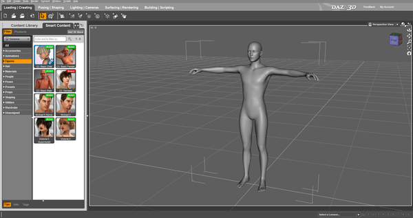

    I have two "genesis.duf" files that, when loaded, appear to be the base shape, and display no attribute/settings under "currently used" in parameters. See the images attached - I made no changes to the genesis figure in the first image (tff1), saved it, then loaded it. The loaded figure, scene in the second image (tff2), is the untouched genesis figure previously saved with no alterations.
    When the genesis.duf files are loaded, and the zeroing/restoring steps are taken, there is no change to the shape and there appears to be no parameters applied. When I do it with the loaded "problem file", nothing appears in "currently used" but I can go in to the parameters for the various body parts and change the defaults & values (interesting, though, that the values on the icon for each respective part are grey, not white). But, if I try to "save modified assets" after, it says: "no assets have been modified" - or something to that effect.

    The screen shots aren't very informative, but the second figure should be changed by zeroing it since morphs are set (restoring sets them to their memorised state, which can be stored in the .duf file to override the default; morphs which are in their default stare, even if it is non-zero, will not show in the Used list).
