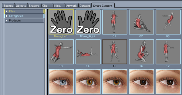

I purchased Hand Dany (http://www.daz3d.com/handy-dandy) for use in Carrara. It looks really helpful for fixing issues with Genesis and Genesis2 hands when importing poses meant for other figures. I installed it using the DIM in a folder that I keep all my Genesis stuff. Only the Zero poses show up in the Smart Content tab. There are supposed to be a variety of other poses like G1 to G2 and V4 to G2 that should be there. I poked around in the content files and found that the Zero poses are duf files, but the rest are dsa. Is that the problem. Do dsa files work in Carrara? Does anyone have any idea how to use this product with Carrara.I guess I could pose in Studio and then export the pose as a dug.

    First, thanks for buying Handy Dandy! I don't have Carrara, so I am not sure if .dsa files work in there or not, but I can tell you that your issue is normal as for trying to find the presets. DAZ has placed them under Default:Scripts:Utilities in DAZ Studio, which is not where I would have put them. I have trouble finding them, myself, and I was the one who made them.
    I don't know how the Smart Content is setup in Carrara, I really wish I could tell you how to find the presets. The other difference (aside from being .dsa instead of .duf) is that all of the other presets besides the !Zero poses are Script files, not Pose(s) files. That is why DAZ put them in a different category. Are you able to run other scripts in Carrara? If so, Handy Dandy may be located in the same place as those files.

    In the Carrara browser they are located in DAZ Library:Scripts:Utilities:Slosh:Handy Dandy.
    As stated, ONLY the zero poses appear there.

    I'm a bit confused. Yes. i can find the files in my runtime with a path similar to the one you indicated. They don't show up in Carrara for me at all. Since they are scripts, I don't think Carrara can use them. Is that correct?

    Yes, Carrara 8.5 can read .duf but not .dsa.
