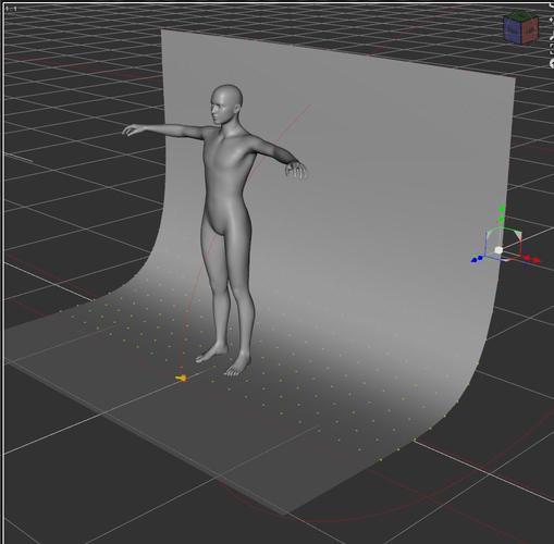

    Make sure you plane has enough divisions (in the Create New Primitive dialogue) for the DForm to be able to bend it, adjust the DForm's field so it encloses the part of the plane you want to bend (and stretch it out across the width of the plane so that it affects the whole thing evenly - you can use the Adjust Spline button in the DForm pane to alter how the effect comes in), put the base at the top of the bend zone (that's where the hinge pijt will be) and then select the actual DForm, which is a child of the base, and rotate it.

  • simon_3f3af8b4adsimon_3f3af8b4ad Posts: 0
    That looks great! Could you describe what settings you used to create that? I'm not experienced with dform :)
    Thanks so much for the help.
