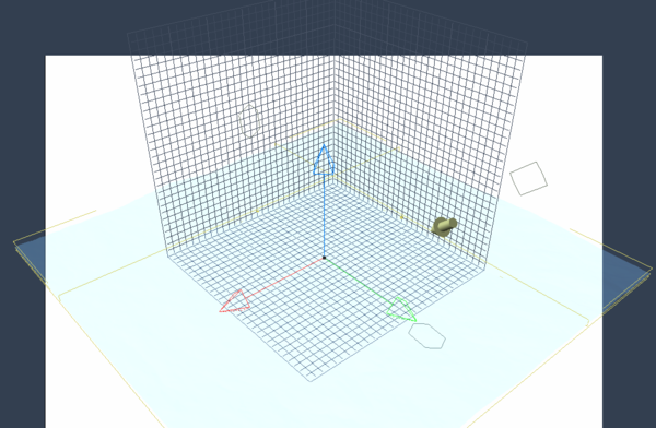

I am new to Carrara and I have an issue where when I hold down X and do a test render everything works as expected but after I am done with the test render I can rotate my scene around but I have a giant white remnant where the test render occurred. Does anyone know why the screen is not refreshing and getting rid of this or how I can manually refresh the screen to get rid of this problem?

    People may need some more info on this. What's the version? C8.5 32 bit? 64 bit? What's the hardware and OS?

    Disclaimer: I'm on a Mac and have C7.2. However, I may have a way to test if the issue is graphic card related.
    Do you know about the Interactive Renderer? It's accessed by clicking the little circular icon with the up arrow in the center. A window will open allowing you to set various display options. There's a pull down menu on the top right, that allows you to use OpenGL or software rendering for the assembly room view. Any changes you make in the Interactive Renderer only effect the Assembly room view. The do not have any effect on the Render room settings.
    Anyway, toggling between the OpneGL mode and software mode, may tell you if it's a graphics card issue, a Carrara issue, or an issue with Carrara and your graphics card. ;-) When changing the render option, you'll need to click Okay before the changes will take effect.

    Here is a screenshot with OpenGL and Software selected in the Interactive Render Settings. What is weird is that it is persistent. If I do a test render around the white area it will render the ocean and show a black background but it will still render the white area as well. Also, I have saved the scene and when I open it back up it is still there....kinda seems like a Carrara problem to me.

    Sounds like a bug for sure. Can it be reproduced in a new, similar scene?

    Evilproducer, the spot render tool is the tool that I am having the issue with. It doesn't always happen. I created a new scene and it wasn't an issue. It is worrisome that once the problem is there, the scene is basically corrupted by this problem. I don't know yet if it causes problems in the final render but it makes working on the scene almost impossible..

    Regarding the issue with the spot renderer, I would file a bug report. If you can, include the scene file that's causing the problem.
    Speaking of problems, I have to ask, how many scenes do you have open when this bug hits? Could that be a cause? I would say it's still a bug, but it may help to reproduce it.
