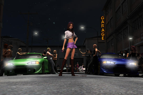

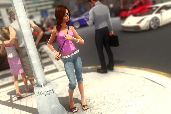

    I have done several large scenes but none animated. Your approach of making smaller scenes and merging them is the same approach I use. i tend to split it up by characters as I find that the props and buildings tend to take less resources so I am willing to group more in regards to structures. What you may want to do is use Depth of Field when rendering so you can be both artistic and conserve resources at the same time as it will allow you to use lower res background characters (cause lets face it, no one can tell who is who when its all blurry)
    Below are my two large scenes that I have done.
    First one was finsihed in April of 2010 and the second was done earlier this year.
    1280 x 853 - 873K
    1280 x 853 - 821K

    Very nice work, lots of characters (heavy on RAM I guess) Matty. Yes, I know Depth of Field is my friend (and in fact I like rendering this way particularly as my project is based on a "subjective cam view"). My first intention was to build empty buildings and surroundings for large subscenes but I have some positioning problems as it is hard to work with void scenes and no floor grid for distant parts.
