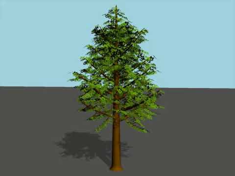

    This works pretty well, but your leaves need to be flat polygons with an alpha mask to create the leaf shape, otherwise if your leaves have more geometry the Displacement might distort and crumple them too much. Here is a test:
    This is a simple default plant and I substituted the default leaf with a flat polygon. I then made a new Shader and put Fractal Noise in the Displacement Channel. I animated the noise along the Y axis. For some reason, maybe it's a Mac problem, I don't know, but using the Transform Tab for the Noise Functions doesn't work for animation (for me at least), you have to drill down and use Origin X, Origin Y and Origin Z, and since there are no controls for those in the Shader Room, you have to add keyframes and then switch to the Graph Editor to change the values.
    Not sure it's the realism you are looking for but might be worth a try. If it's more than one tree I would try switching from Local to Global space for the Fractal Noise so they don't all look the same.

    Another quick test, agh, I'm supposed to be doing other things...can't stop Carrara-ing once started...  :)
    This time I used an alpha mask on the flat planes and used less contrast in the Fractal Noise:
    Edited to add: one could load several different leaves onto the tree, each with different Displacement for even more variation if this seems too uniform and "ocean wavy".

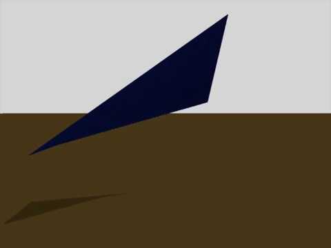

    Here is another test, I think I was able to successfully 'pin' one edge, but still can't get the two points of the other edge to be locked together.
    I used a Mixer in the Displacement Channel: Fractal Noise, a Color of 50% grey and the Blender is a Texture Map with a gradient that goes from 50% grey to Alpha. Not sure how to put this is words, but I believe in Carrara 50% grey equals no displacement, lower values displace down and higher values displace up. I think as the animated Fractal Noise passes over the Alpha area is gets exposed and distorts the points on the other end of the polygon.
    And actually, the replicated trees example in the video still uses the initial set up, so all 4 points of the polygon are being distorted, but because of the distance of the camera it's near impossible to see.
