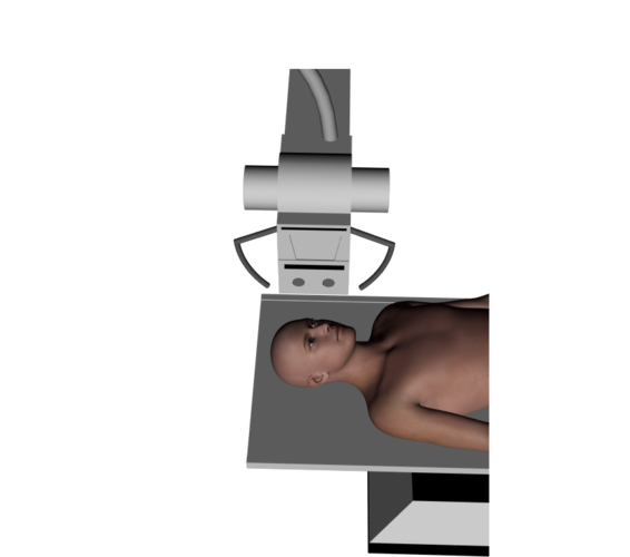

Hi,i have big problem,i must do xray picture,but,lights must be on his head with x mark(like a real xray) i dont know how to do that,help me or give me real good tutorials,pls someone Thanks!

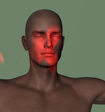

Can be done with a spot Light and a primitive plane with a couple of easy to make textures applied to the surfaces of the plane.

I also think that, I'm new in DAZ,I do not know exactly how to do it ... if you can explain a little better,...

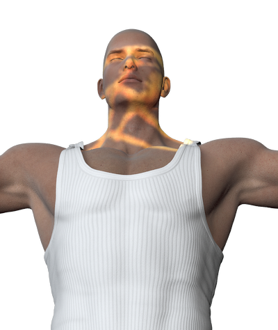

or maybe,can i put some object and spot light on it,to make a shadow on patient head ???
I think that's what Jaderail meant. Easy to do. If you make your own transmap you can apply it to a “plane” primitive. All you need to do is go into photoshop or similar and paint your cross or X with black and white. I think black is opaque and white is transparent - can't remember because I have two programs that do it opposite ways. Save your image as an obj or png.
Load your plane primitive in DS from the “Create” menu > primitives.
From there you just go to your surfaces tab (wile your plane is selected) and load your transmap into the opacity slot.

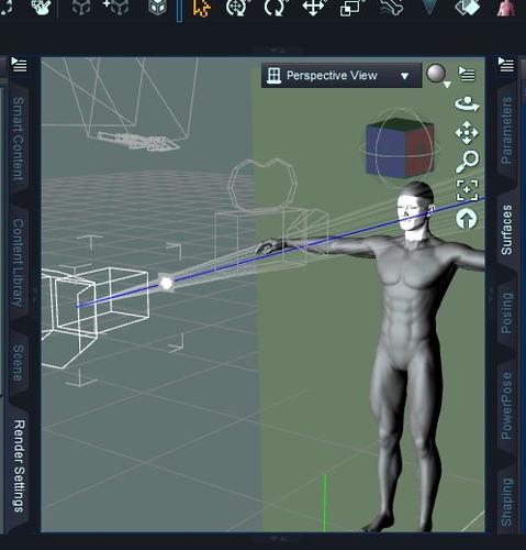

@jimzombie thank,i do some pretty good job,....but i want it that like shadow,...now i have just object but that object go beyond my genesis,iwant to put on it,like a real shadow....

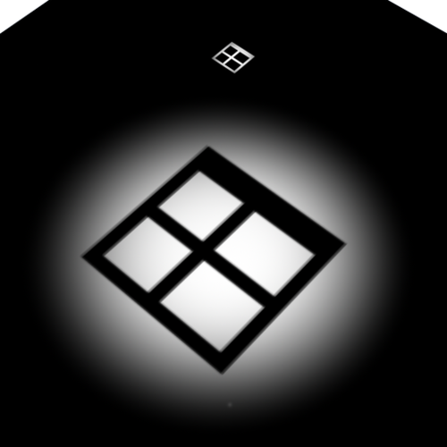

Greetings,
Something like this. (Images attached.)
What I did was create a large plane (the object to put the shadow on) and a smaller one (the one to block the light). I marked the light as having raytraced shadows (because they're faster than deep shadow maps, which makes no bloody sense), and a 2% shadow softness. I moved the blocking plane to RIGHT underneath the light (as you can see) and after a test render that showed that it was blocking it, I used the Polygon Group Editor to select squares from the light-blocking plane. Once I'd built a small window in selection, I right-clicked and 'create surface from selection'. I selected that surface in the Surfaces tab, and set its opacity to 0. Voila, instant window-type shadow.
To do it properly, I should probably make the blocking plane larger, so the light doesn't bleed past the edges, but this was just a demonstration.
-- Morgan

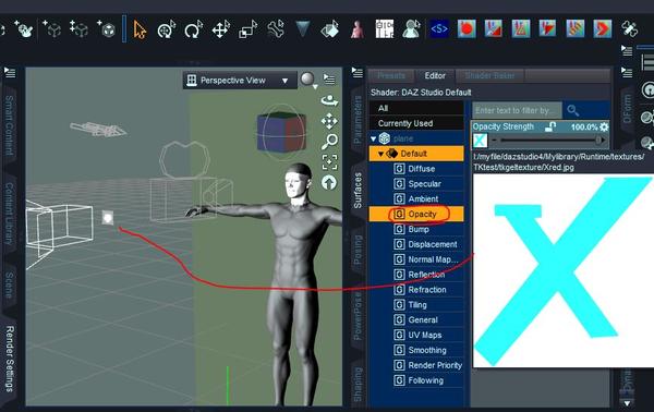

And if you hope to something like gel color effect,
make texture with black background and ray color.
then inverse pixel tone. in your draw tool. (Gimp photo shop ,etc)
it make white background and inverse color mark (or tatoo etc) image.
save it as jpg, then apply it on the filter plane opacity strongness .
or you can simply apply the original texture with black background,
then inverse pixel tone by DS Layer Image editor too.
you can access LIE by Right click the texture map on surface tab.
there is inverse option.
how you set spot light angle, locate and resize the gel plane.
the reflect lay size change.
And you may need some test to get the effect which you hope.
(more narrow slit texture make more clear effect
in may case the letter width is too wide ,,, )
after that make spot light as parent of the thlit gel plane.
then you can save it as scene subset.

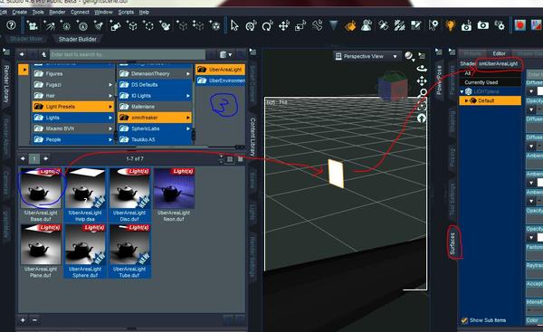

If you try to use Uber Area light shader, as emitter,
and set Primitive Cone as cover of light ,
and make gel plane, apply texture as opacity map,
it can work too.
I hoped to talk about gel mesh light,
and how to make simple mesh gel light by ds tool only,,,
but spot light is more simple, and maybe easy to set up .
THANK YOU GUYS! BINGO!!! Now I have to try it, I hope that everything will be ok,....
