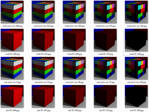

Does anyone know if there's really a difference between the Layer Subtract and Layer Multiply operations in Shader Mixer? I ran some comparison tests using colors and I'm really not seeing any difference between them. See the attached images, in which I multiply primary and secondary colors together, as image maps and as color values.

    I had a whole range of values for alpha. It turns out the problem was the base and layer. At full-strength channel values (e.g. 255,0,0 or 0,255,0) the results of multiply and subtract are the same, but with half values, e.g. 128,0,0 and 128,128,128, the differences are apparent.
