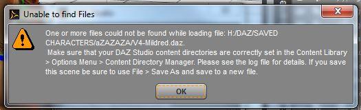

I thought I could just transfer them to an external hard drive and acess them via a standard system-wide search via DAZ3D content manager. It seemed to have found them BUT I am getting many errors when loading. It can not find many (if not all) the dsf files.
Some assets needed to load the files were missing
the figures load as primitive cube shapes.
This seems to be a problem with the newer .duf files. The older. daz files load. Some load with an error message that not all files could be found BUT the figure(s) load.

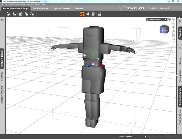

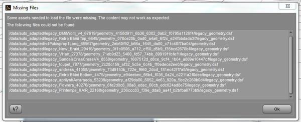

    Hello everyone,
    So I Matched the files on the external drive with the ones on my laptop.
    I am running DAZ3D using the external drive on my desktop.
    I am still getting the same problem though.
    When I load a previously made .duf file I get a large list of missing .dsf files.
    Then the figure loads as primitives:
    I remember previous versions of DAZ3D promting me when it couldn't find the files. This seems to be gone from the latest version. Too bad.
    Any Ideas as to how to correct this problem?
