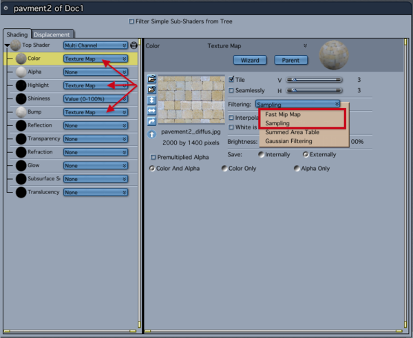

    It's found in the Texture room.
    It's the drop down menu for the "Filtering" option of any shader channel that uses a Texture Map.

    You can correct the texture map filtering selection in version 8.1.
    If you have one that used fast mip map in 8.5, the texture map won't display in 8.1. But you can still change the filtering by selecting "Sampling" from the menu. Only the Fast Mip Map selection will be missing.
