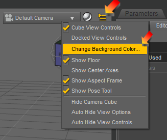

Now, If I can just figure out how to turn the working background to black. I know how to do it in Poser, but I've looked all over the place for it in D/S - everyplace but the right one, apparently.
Yes, I *have* been watching tutorials, but if it's been in there it slid right by me.
Here you go. A picture speaks I'm told...
