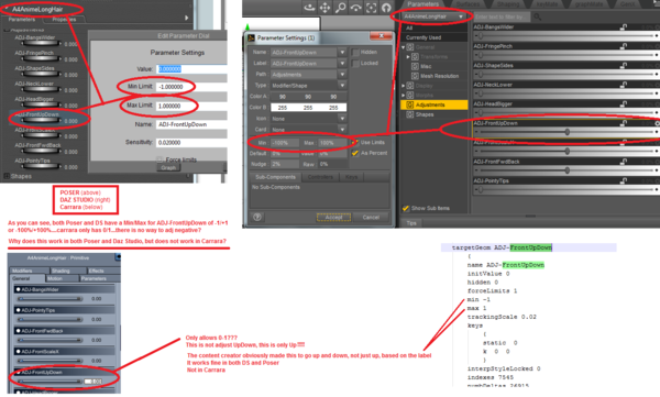

I loaded Aiko Long Hair, and was going to lower the ADJ-FronUpDown, but the min is 0 and the max is 1, only allowing me to go up. I double checked in DS, and the min is -1 and the max is 1, going both up and down. I can type in -1, but no effect in C85?
Is there a way to change the Min/max setting on something like this? They show up on the General Tab.
EDIT: Looks like PT-UpDown (ponytail updown) has the same issue.

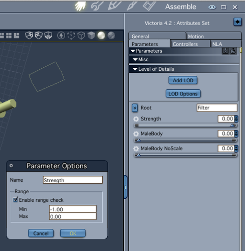

    3doutlaw,
    You're in the wrong tab. You need to be in the Parameters tab to access the setting. Click the small gear to the left of the name and you will get a window to change the limit.
    513 x 525 - 66K

  • 3dOutlaw3dOutlaw Posts: 2,481
    I do appreciate the assistance, but this is why I mentioned I was on the General tab.
    The adjustments for this are not on the parameters tab, they are on the General tab.
    Just so we are all on the same page, here is a screenshot of the parameters tab.
    So when the morph adjustments for an object (not a figure) are on the General tab, is there a way to adjust the min/max?

    OK, so my ticket was closed, since "It shouldn't need to be fixed in Carrara since it only affects a very limited set of Content."
    I am able to replicate this on any "prop" that has a morph which has a +/- morph adjustment (i.e. in/out, up/down, front/back, etc) Seems to affect a lot of hair props, since hair can adjust both ways.
    I attached an example I submitted.
    Anyway, does anyone have a workaround for this?
