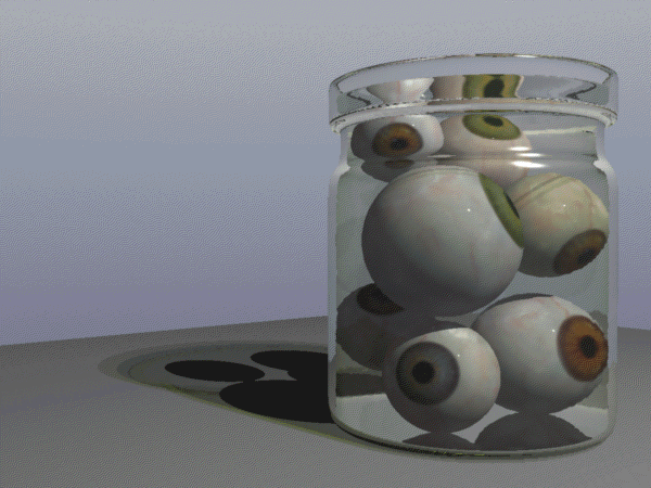

Just for fun, I want to create an animation in which several eyes in a jar start out pointing in random directions, then at about one second on the time line, they all look at and follow the camera.
Each eye has a Point-At modifier set to point towards the camera. At one second on the Sequencer time line, the Point-At modifiers are enabled with a key frame, causing all of the eyes to turn toward the camera.
However, the eyes turn too quickly at the key frame, and adjusting the tweeners have no effect on easing-into the Point-At.
Anyone know of a way to ease into the point-at rather than have it occur so suddenly?

600 x 450 - 4M

    Well, here's the result.
    Thanks for the ideas!
    600 x 450 - 5M

    Ah! The light bulb has come on!
    By toggling open the object in the sequencer, it's clear to me now just what is happening. This works perfectly. Thanks for taking the time to explain it.
    This example was made using this technique.
    600 x 450 - 4M
