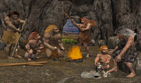

    OK... second attempt to post...got logged out!
    Ok....I tried saving without compressing (locally which is how I was doing it before) and the file went from 87mb to 446! It originally was 300mb before I removed all those Objects that were not actually in the scene vs their Instances. So I put it back to compressed save and the file went back to 87mb. Task Manager shows 1.9 gb.
    I have 6 Genesis figures... (see attached WIP scene) and they are all variations of each other that were loaded from the browser except for one which I just duplicated in the scene since I was only changing hair colour and shrunk the size of the body a bit (the child was duplicated then made into the seated toddler. All are very hairy. Did I read correctly in a recent thread that the more Genesis figures you have the more cumbersome/slow the file becomes?
    Am on the verge of uninstalling and reinstalling........ or topping myself (which might be easier at this point! ;) ) But am actually going to go out for a walk for a while.
    Thanks to all for help... you have no idea how much it is appreciated. I really need to turn my assignment in this week as I got an extension after telling of my Carrara woes.
    Cheers, SileneUK
